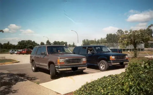

Heres a pic of my drivers side after removing the pnstripes and body moulding. Big improvement i think.

with the pinstripes i heated it up with a blowdryer in small sections and would peel it up, heat some more and peel that up, etc. It goes pretty quick taking of the stripes. The moulding is a different story. I just grabbed hold of it and peel it off which left the double sided foam junk. I found that a heat gun worked better than a blowdryer, but you could use either. I heated up small sections of the sticky foam and rubbed it off with my thumb (be ready for blisters!!). After all is said and done, just take wipe the areas down with a wet towel to clean off any dirt that was under the moulding and around the pinstripes. Then just give the areas that had been covered a good coat of wax and enjoy!
