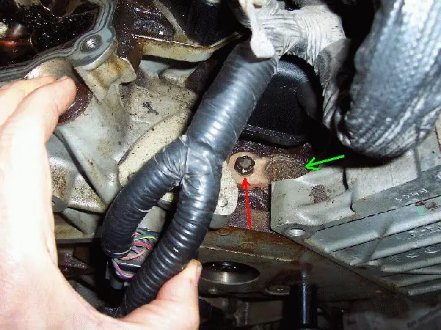

It is still possible to spin the oil pump by connecting a drill to the intermediate shaft. However, the shaft access cover is at the rear of the engine under the upper intake manifold. Ranger7ltr did this before starting his rebuilt engine and posted a thread about it. I believe removal of the upper intake manifold is required and a female hex bit is needed to mate with the intermediate shaft. The hex bit must be securely attached to the drill or there is the possibility it will remain attached to the intermediate shaft when the drill is removed.
The photo below shows the location of the access to the intermediate shaft drive gear.
The green arrow identifies the drive gear access cover and the red arrow identifies the cover retaining bolt. The engine was mounted on an engine stand when the photo was taken.
