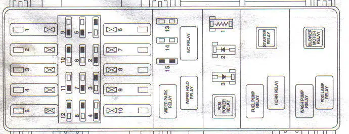

OK here's the deal, 97 explorer sport. Girlfriend just called and she stopped and got gas and now it won't turn over. I know its not the battery since jumping didn't help. I'm figuring some relay since she checked fuse panel inside and no blown fuse. The problem is is I don't have a manual showing relays etc. Any quick suggestions? Otherwise I'm gonna take a screwdriver and jump the starter during lunch to get her home. The starter isn't clicking or anything.
Thanks,
Chris
under hood by power brake booster is this distribution box
Thanks!
I'm gonna check it tonight, I think its either the relay or starter.....We'll see I guess (relay would be easier though :D ).
