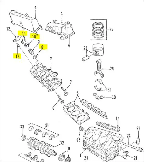

@410Fortune and @Fix4Dirt - Apologies; I'm not clear. I (think) I know which part you're referring to, but I'm not 100% sure. It seems like the parts have many different names. Here are the parts from the Ford parts diagram (below). Regarding the part that (might) be clogged (and causing the ticking sound)... is it part #13... or some other part number? Please advise. Many thanks.
2000 Explorer XLT 4DR 2WD 4.0L V6 SOHC JOB1, 5-Speed Automatic O/D 5R55E, 149,000 miles.
#8 - Valve Seals - Ford (F77Z-6571-AB)
#10 - Valve Spring Retainers - Ford (F77Z-6514-AB)
#11 - Valve Keeper - Ford (F77Z-6518-AA)
#13 - Valve Lifters (Engine Camshaft Follower, Adjuster Assembly) (Exhaust) - Ford (F77Z-6500-AB)
BTR - I'm not sure if it matters for your question regarding what product would help, but your diagram is not one of a SOHC engine. That is an OHV engine, push rods, rocker arms, etc. Ford had both 4.0 SOHC and 4.0 OHV engines in the Explorers/Mountaineers/Rangers.
@swshawaii - Thanks, but I've ruled-out the tensioners. I'm solely interested in fixing the ticking that's coming from one of the valves, i.e., the Valve Lifter (Engine Camshaft Follower, Adjuster Assembly) Ford (F77Z-6500-AB) appears to be either (1) sticking, or (2) needs replacement.
How or why did you "rule out" the hydraulic tensioners and three plastic timing chain guides without removing the valve covers or the oil pan to check for broken plastic timing chain guide remnants? As we know, isolating valvetrain noise can be very difficult under the hood. Faulty timing guides are by far a more common failure than cam follower noise on the 4.0L SOHC. For your sake I hope it isn't guide related, but you need to dig deeper. Good luck.
@colocat94 - The diagram is the 4.0L SOHC. You misspoke... there are no pushrods in the diagram. However, there are Rocker Arms (Ford YL2Z-6564-AA) and Lifters (Ford F77Z-6500-AB) aka Engine Camshaft Followers.
@swshawaii - I ruled out the front and rear chains by (1) using a mechanics stethoscope, and (2) researching and understanding the differences between the "clattering" sounds made by chains and the "ticking" sounds made by valves.
I stand corrected. Crow eating commencing!
