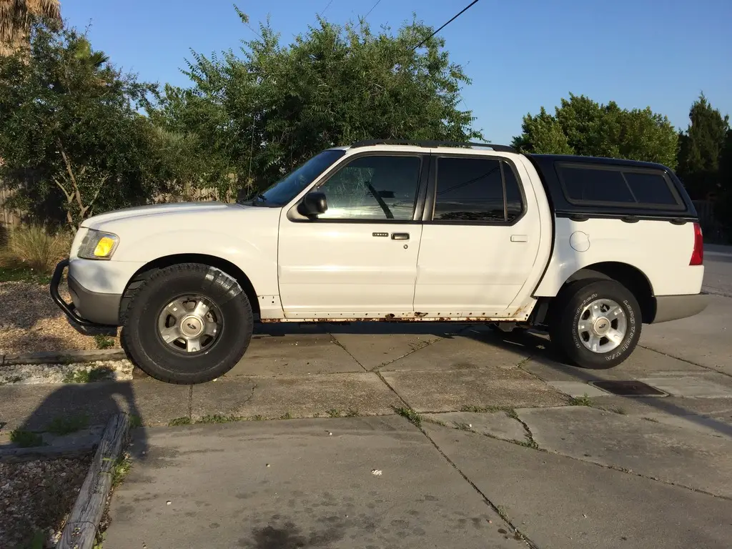

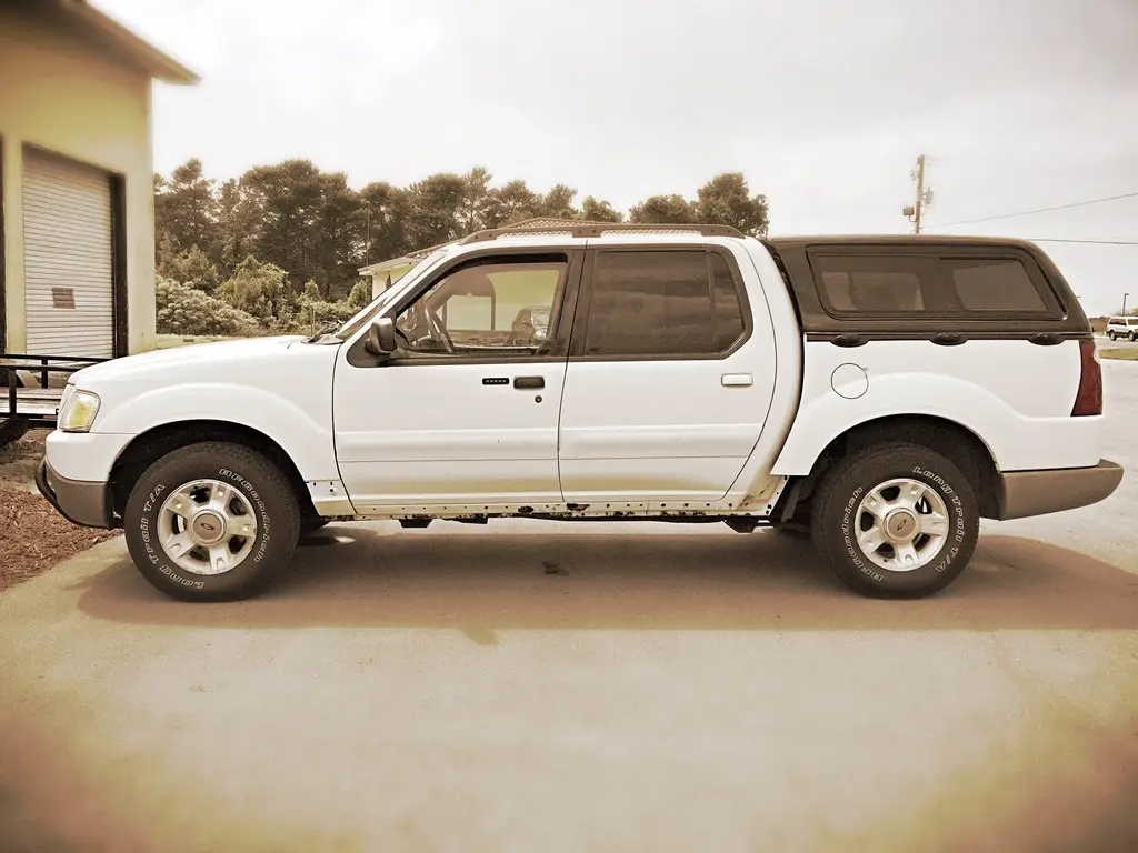

This is her. I have always felt the tires were to small in its current condition (stock) but I also don't want to lift but will 1-2" if it's needed (I think it will be needed, at least tt). Do they look small to you? I had to edit the pic to see in the wheel well better (I know, nothing like Luke's edits). Like I said I'm willing to do a tt for 1-1.5" lift and aal but that will have to come later. I'd like to fill the gap and would like to be at least capable of lite off-road capabilities

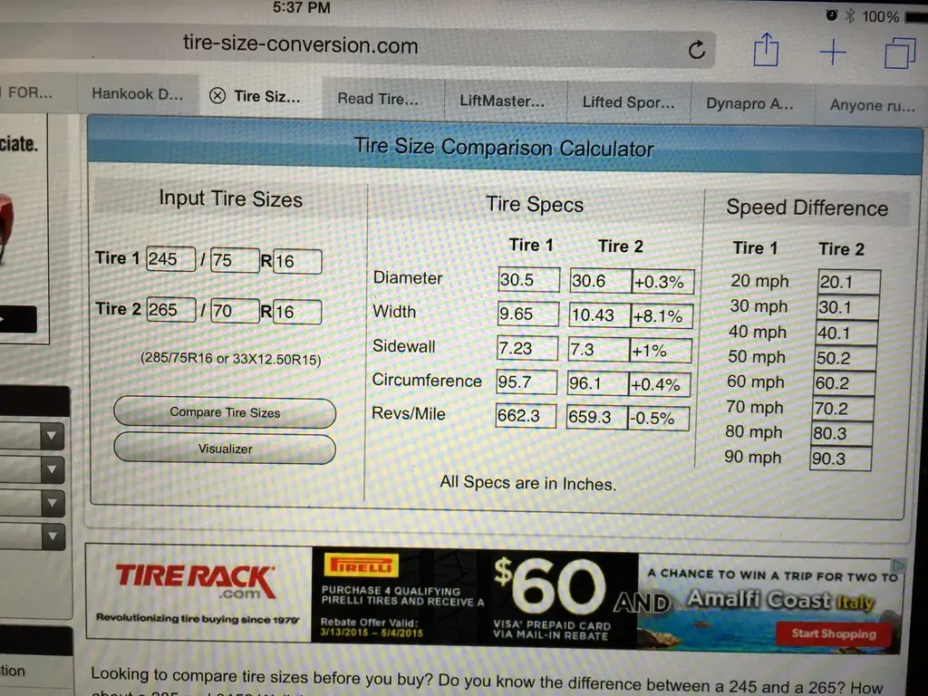

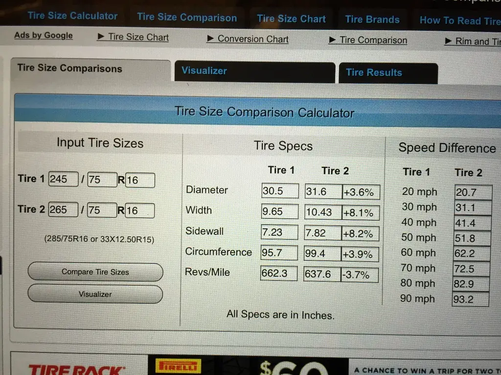

So after doing a bunch of research of tire size and what not it's come to 265/70 or 265/75 leaning heavily on the 75s. Reason being if I spent all that $ on 265/70 and was hoping for bigger tire, I would be greatly disappointed. My current 245/75 would only be slightly/hairline smaller tire except for width. So from a side shot, it looks like I have a 265/70 in comparison. But the 265/75 would give me at least a bigger appearance than I currently have by actually being bigger od.

4 corners sit like this (taken from ground to bottom fender in picture above. Note ground not 100% level, slopes in the front):
LF-33 3-8" RF-33 7/8"
LR-35" RR-35 1/2"
