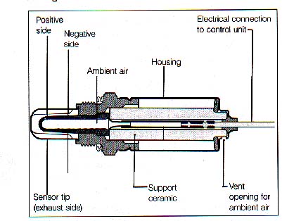

Anyway I was reading and it stated that O2 sensors actually breath through their wires to prevent ash and other buildup. Because of this, the site stated to never use any grease on the connectors. I always use di-electric grease on electrical connections. I could not find a reference to this from a reputable source, and the directions that came with my sensors said nothing about it. In my mind, it seems like total garbage, but maybe I'm unintentionally shortening sensor life. I can't remember the last time I had one actually go bad either.
Thoughts?
link to one of the few sources:
http://www.autotap.com/techlibrary/understanding_oxygen_sensors.asp

You basically are saying the same thing the link says you just explained it more detail.
I was interested in this breathing thing I never new this. I looked at a few cut away diagrams of a O2 sensor and they do show it does need to breath. Older sensors had a hole where newer one now just breath through the wire connector they call reference air.
Hmmm, I have never seen that. Didn't see any kind of a breather on the O2 that I removed from my Ex. It looked pretty sealed up. Maybe the air is just for the heater so it can breathe and not overheat? I find that really odd though. It's still got to be sealed for the exhaust otherwise newer cars with downstream O2 sensors wouldn't like that.
