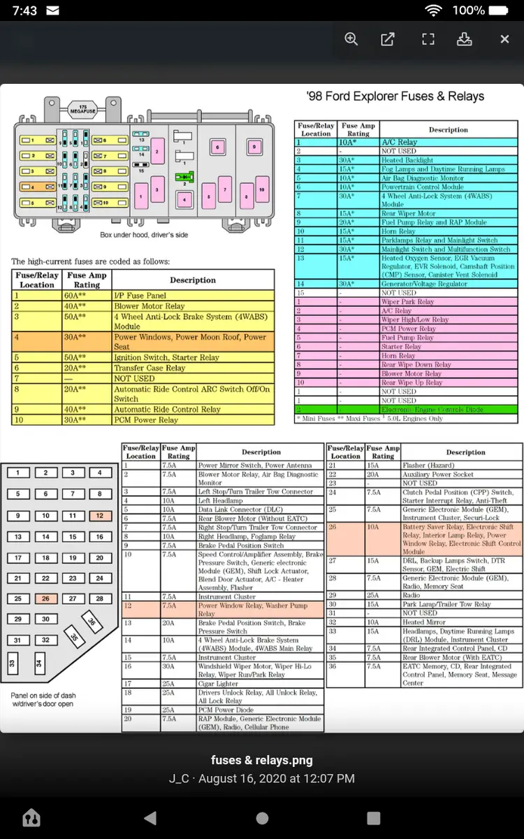

Fuse 17 right? Or am I wrong I may just check all of them.
Check them all with a meter or a test light
I also planned on doing that Donald's lol just cleaning it up first. I'll do that first thing tomorrow with my meter.
I can go get my book out and look see the fuse circuits protected
The other thing that happens w these gen ii is the dash fuse box is hard to see thanks to the drivers door I cannot tell you how many explorers I have seen where they simply pulled a fuse looked at it and then put it back in the wrong hole so that it now powers nothing, it is easy to put them back in the wrong spot! Have fixed a couple of things this way over the years
