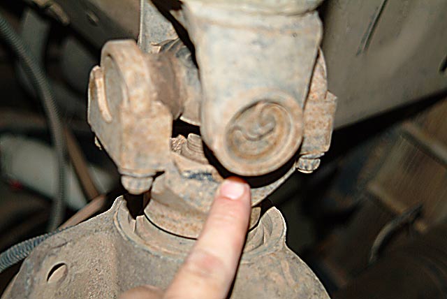

Rear is another story. I have bound those up and busted them in the past. I have since went to a 1350 with a billet yoke which I ground out for more clearance. That is almost enough, but I can still see that the yokes are rubbing together. This offset joint should be just the ticket.

Got a pic of the joint and where it was grinded? :D
Here ya go...
