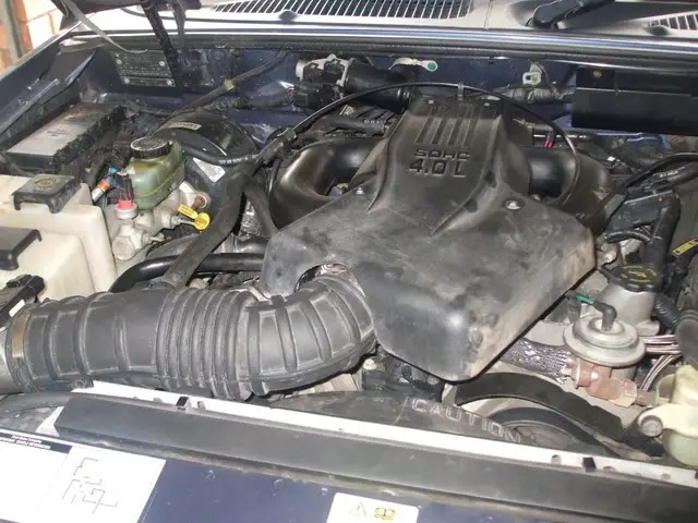

i have a 2000 Explorer XLT 4.0. How do i know if i have the OHV or the SOHV,
Sohc?
This is what the SOHC looks like under the hood.
8th Letter of VIN E = SOHC X = OHV
lol ya i didnt even think to check the intake manifold. i noticed the 4.0 when i bought it but didnt even notice the SOHV.
ya mine is the other way too with the fusebox n master cylinder on the otherside. y is yours the otherway. is it just a model year difference or something
his is a right side drive.. thus his fuses, brake booster locations are all reversed
Yep, that's right. We drive on the wrong side of the road here in Australia so I have the right hand drive Explorer Export. The heater hoses even run across the back of the engine to get to where they are supposed to be. But they come with Floor shift transmission shifter so that's a bonus.

And the Great Blee1099 :salute: spelled it out. It is a right side drive, but the engine is the same.

Just FYI its SOHC (single overhead cam) not SOHV.
