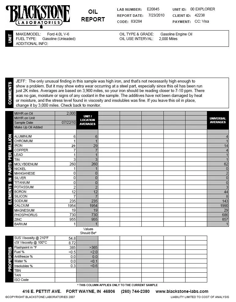

Anybody with more knowledge then me have any input and advise on this first analysis that i had done switched from regular oil to Valvoline 5w40 Blended Synthetic.
