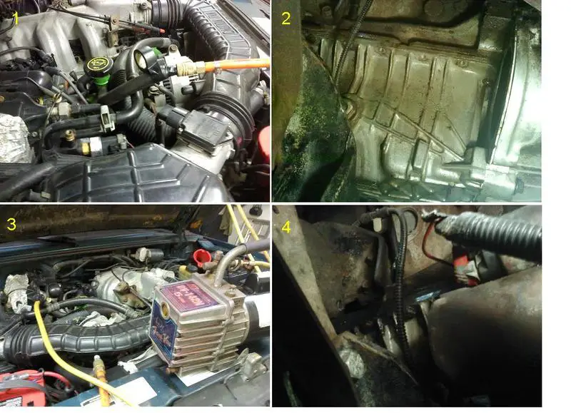

1. Hook up Air compressor to pressurize Crankcase, found leak with soap bubbles. Not to mention oil present.
2. Removed starter and oil pan bolts, cleaned thoroughly with carb and brake cleaner, plus a wire brush. Rubbed silicone sealer on leaking spots.
3. Pull a vacuum on crankcase, sucks silicone sealant right in.
4. Reinstall starter and allow silicone to cure overnight. Test tomorrow.
