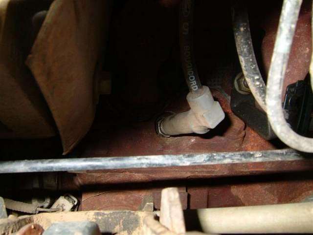

I think I see it. On the topside of the engine, running north to south, in a threaded hole?
Bottom left corner of the pic-
Is it not on the top of the engine, here is a pic:
Yo Green, where did you snap that pic from, the wheel well?
If so which plug wire is that?

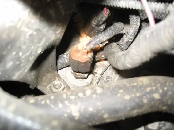

Wow, looking at V8Boatbuilder's writeup, it may be worth $90 to have it done!
I would think there would be an easier way. He went through quite a bit to get more room and access to try to put in a different sender. I would think if you could get a socket over the sender, you could remove it with an extension and universal. ??
THat would be one heck of an extention.
If I can get my hand back there to disconnect the harness (haven't tried yet) then maybe I'll give it a shot.
