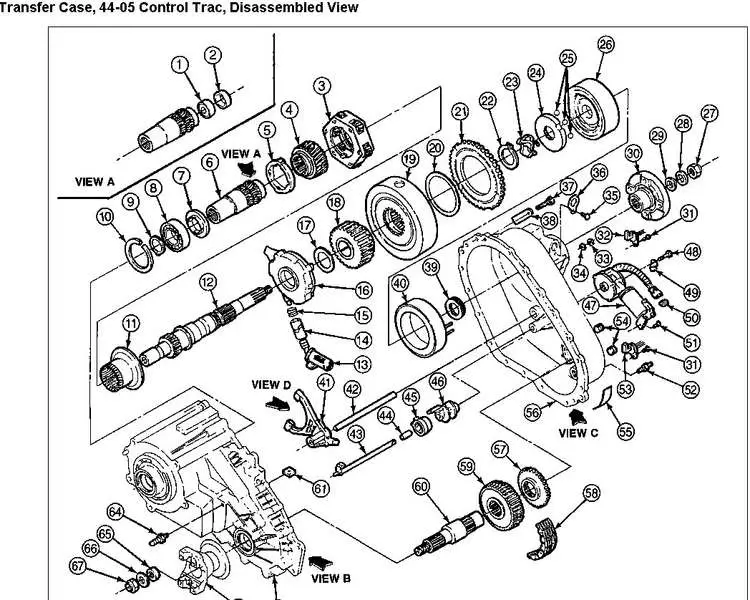

Well why don't you just drop the case and have a look see? It takes less than an hour to do, and the case it self is actually quite simple.
Does anyone have a break down of the transfer case
Most on-line T-Case vendors have a break down...give me a few minutes and I'll check my hard drive...
