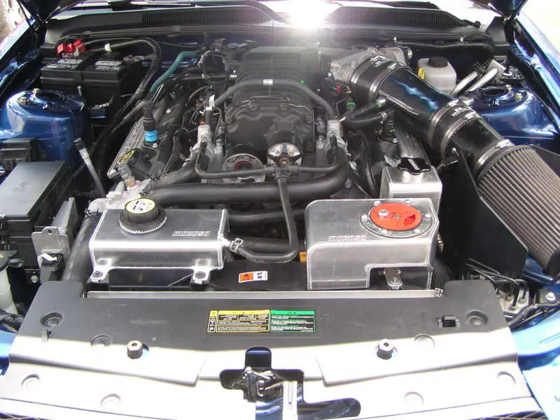

As you well know our 2008 Shelby Coupe was taken from a Stage II set-up:
to a KB 2.9 Comp package:
and made a healthy 737rwhp when it was all said and done, trailered to the Silver State classic and ran to a 1st place win:
Now even though I still hadn't gotten all the bugs out of it, we didn't take it to the invitation only Shelby Terlingua meet, but three days later we DID however take it to the Texas Mile where unfortunately all the smoke was let out of the motor on the first pass:
Doing our best Blue Angles imitation it was displeasing to find that three cylinders had a compression reading of "0psi" and one had a reading of "69psi" from the noise the KB made while in the pits, and confirmed by other disgruntled KB owners this blower with a whopping 200 miles on the clock cratered the gear drive creating more than normal heat causing an increase of IAT's that the intercooler couldn't displace and causing pre-ignition detonation, thus damaging the engine.

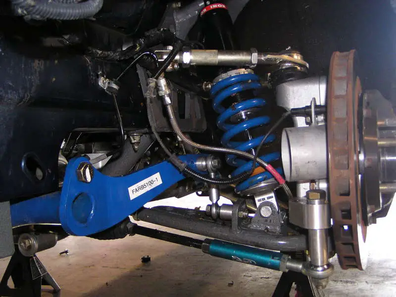

With this we'll go ahead and get a set of Borla LT's for me to mod around the Griggs GR40RT suspension and bolt right up to our Borla 3" system that hasn't been installed.

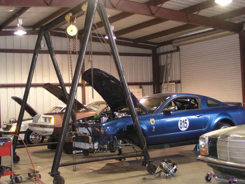

So let's get the ball rolling, as of yesterday I drained all the fluids and prepped it for removing the engine out of the bottom of the chassis:

Should have it out and at least sitting on the floor today, I still need to go get some bolts to mount it to the engine stand, but it'll be a short day as I have Rob Zombie tickets for the show tonight, we'll see how far I get today.
There's gonna be some carnage though.
The Grigg's GR40RT suspension set-up is making this a little more difficult than usual, but nothing the Mortician can't handle.
^^^what he said! that and that throttle body is big enough to suck in small children. i would have to say, this is the part now where i DON'T envy you, Jeff.
You should come over and lend me a hand, come on! Don't be a wuss.
wow jeff, you don't screw around! that and i bet you weren't planing to use that "A" frame this soon.
Belive it or not, that is exactly what I had bought the gantry ("A" Frame) for, so I could do this job.
At $250 with the 2 ton chain hoist I wold say it just paid for it's self.
And remember kids, don't try this at home, I'm a trained professional whackjob!! :confused:

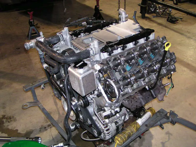

I really don't belive it to be any worse that a 4.0 SOHC motor, the only thing I can tell you at this point is weather the heads are ok or not.
Don't think I'll get to the "Carnage" you all are looking for today, as I have to bail early for the Zombie concert tonight, but I'll be sure to get that good stuff for you tomorrow.
And the cool thing is at this point I'm in the same boat as you all are, as knowing what I'll find.
To date:
2 cylinders read "0 psi"
1 cylinder reads "69 psi"
The rest are all "175 psi" or above
The motor ran, not well, but it ran and drove it's self into the trailer, and out at least twice before this tear down happened, and the blower make a horrible knocking noise, NOT the motor, but there is substantial damage to the motor, no fluids are swapping.
