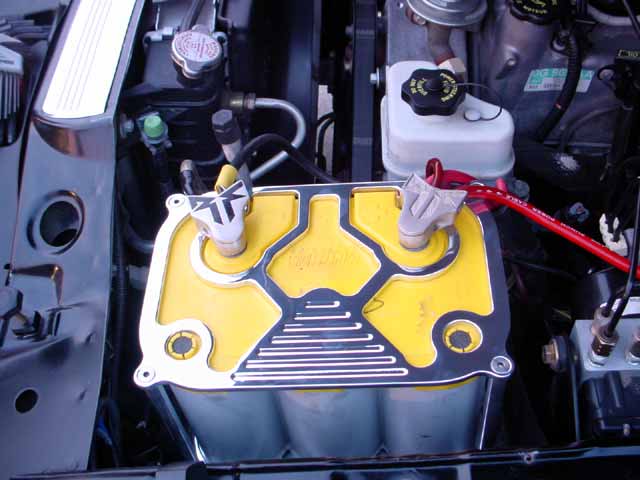

I have been running the Yellow top for almost two years on this explorer. I had one in my old Explorer with 18 aftermarket lights for years with no problems. They are great.
