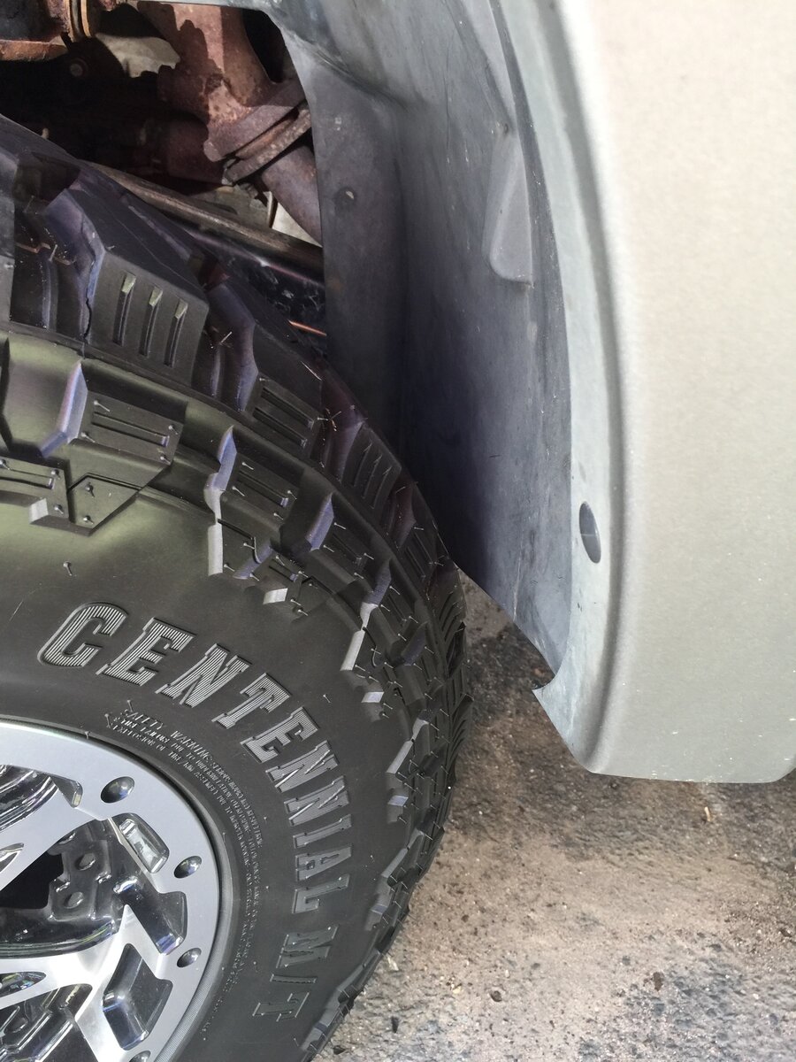

On my 2002 I used -6mm offset rims with my 265/75/16’s, this is with a 3” body lift and 2” spacer lift. I needed to secure back my front fender liners to stop rub at steering lock.
What do you have for rear inner clearance?
Clearance where? From rim to frame? Sidewall to frame? Tire OD to body?
Whatever ends up being closest to the inside sidewall of the tire
