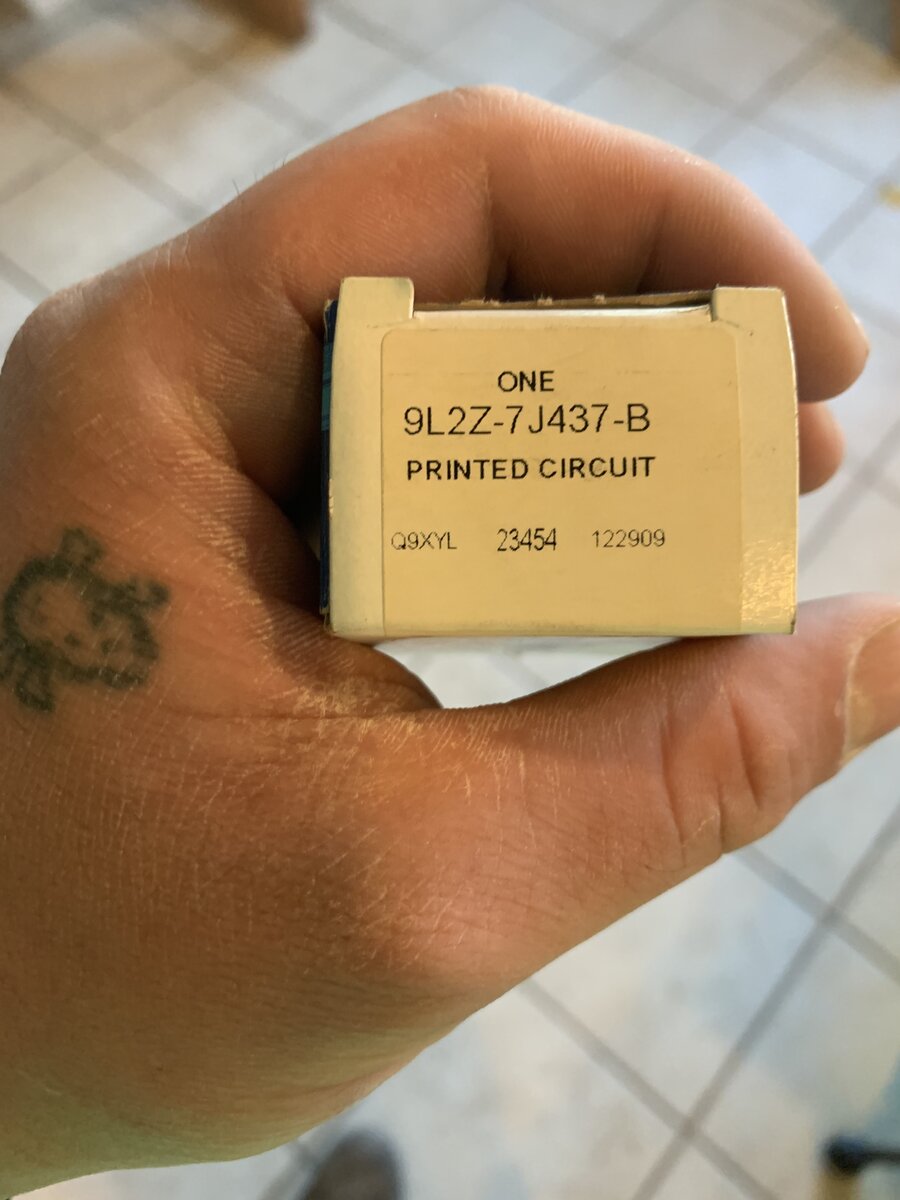

Fixed the issue. After googling and some “down the rabbit hole” searches, I did find another member on another forum that was having the same issue. They said they replaced a circuit board, but didn’t say which it is. Googled “transmission circuit board” and found a YouTube video and how occasionally the gear shifter is stuck in park, the fix was also….a circuit board!! The video gave me a part number, ordered on eBay. Super easy install. Picture of the Ford part number.
