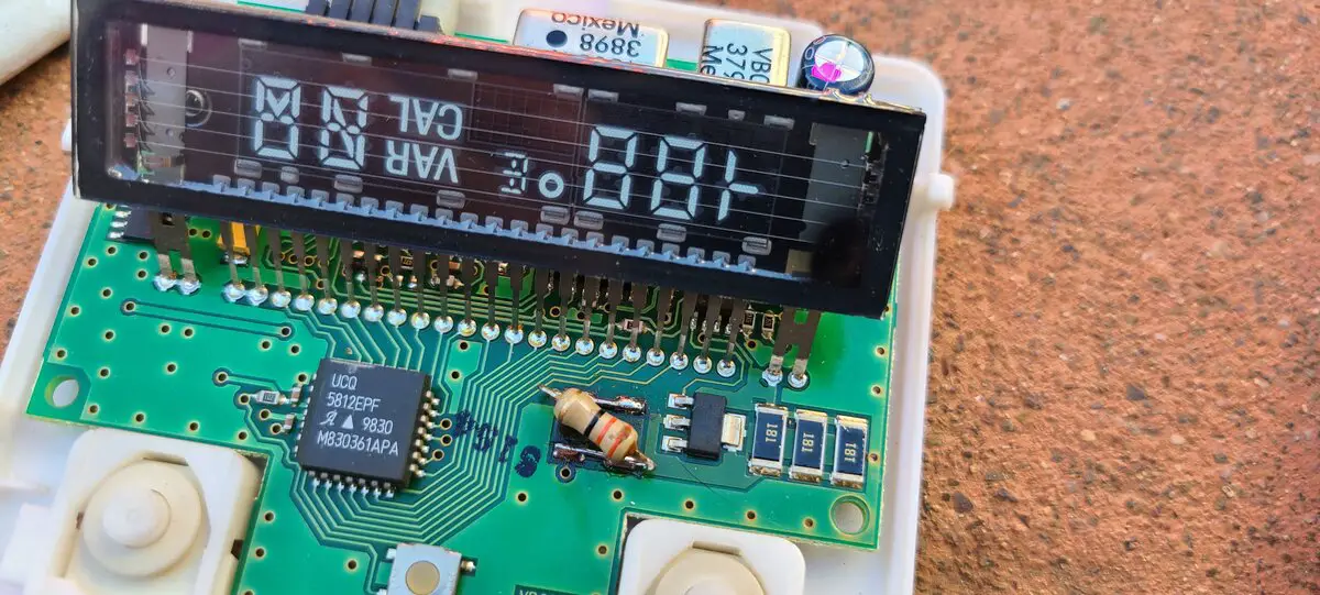

I fixed my display today. My fix did not require soldering as 510 resistors were firmly in place. However, when examining everything with a magnifier; i noticed corroded solders. I cleaned the board and solders and everything works now:-)
The only thing that I noticed that could be wrong with mine is that the lighted display has a burnt spot in one corner.
Pulled mine all apart, didnt notice any bunt, or solder marks. Did notice that my led screen was burnt in one corner thou.
My display quit again and when I opened it up, discovered the display had an burn spot on one edge of the glass about 1/2" in diameter.

That dark/chrome spot in the glass display is normal, and is the result of the "getter" being fired during production to remove the remaining oxygen inside the display. You see the same thing in vacuum tubes, TV CRT's, and nixie tubes.
These are Vacuum Fluorescent Displays (VFD), and I believe those 510 resistors are part of its power circuit.
A bit about these resistors: the three digits represent a value and a multiplier. First two are value, third is how many zeros are after the initial value. 510 is a 51-ohm. 511, however, would be a 510-ohm, and a 514 would be 510K-ohm (510,000 ohm). The board connects these in parallel, which ups the wattage but halves the ohms, taking the circuit impedance down to 25-ohm. A single 25-ohm, half-watt resistor soldered to the pads is more than adequate and will get nowhere near as hot as the factory 510's did.
