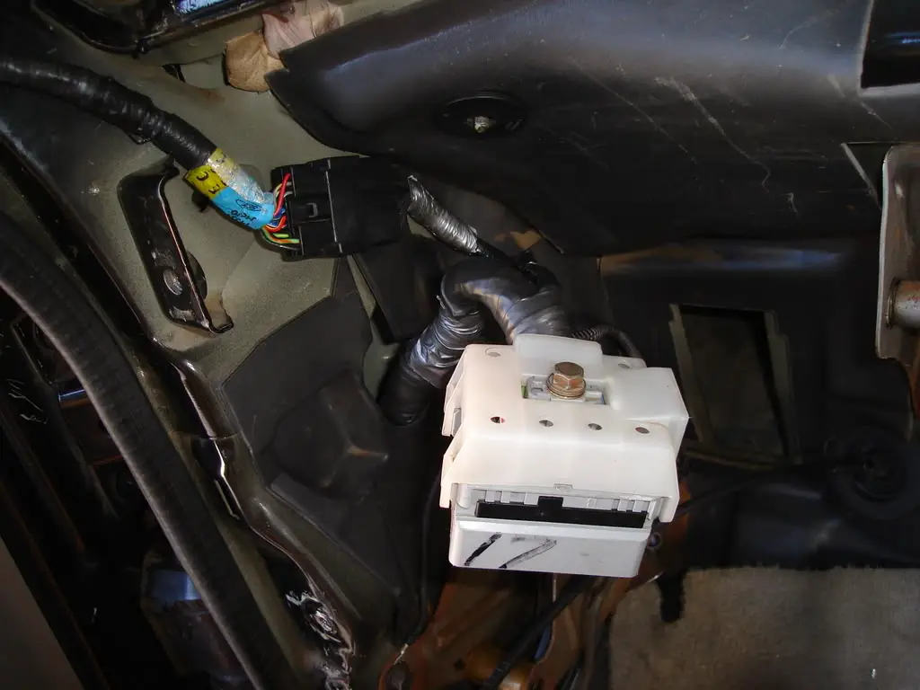

Trying to install an overhead console on my 97 EX, just ahave a few questions that the "How To" didn't explain.
I have the complete wiring harness with the couplers and all, and the external temp sensor. Also 2 overhead consoles, one for the EX with sunroof and one for without.
My questions is, Does the wiring go down the driverside or passenger side?
Also where exactly is the Temp Sensor supposed to go?
I'm about to tear out my dash to see if I can find a connector for the harness and avoid running any wires if I don't need to just in case they are already there.
Any help would be appreciated.
-mc
Hi, mc. Hope this helps:
A-pilar, driver side. There is a conector next to the park brake's pedal. In my case, unfortunately, no temperature wiring.
Behind the front bumper, driver side. There's a conector for the temperature sensor (besides the ABS and fog lamp conector).
I did it in order to get access to the conector and run temperature's wiring through fire panel.
Just in case: http://www.explorer4x4.com/overhead.htm
