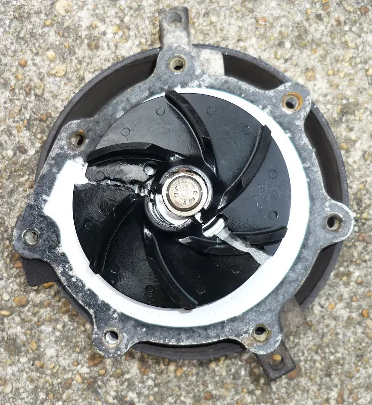

No weird or unusual noises from your water pump latley? I would take the upper radiator hose off and lower off also, then hook my hose to the upper to make sure water is flowing all the way through the block and out the lower hose. Also do this with the heater open and closed so the water goes through the heater core. That should help narrow down what the problem should be. Maybe it is some kind of internal water pump failure, but I would start with the hose. good luck.
Wanna see my water pump on a Mercury Sable that was overheating similary?
