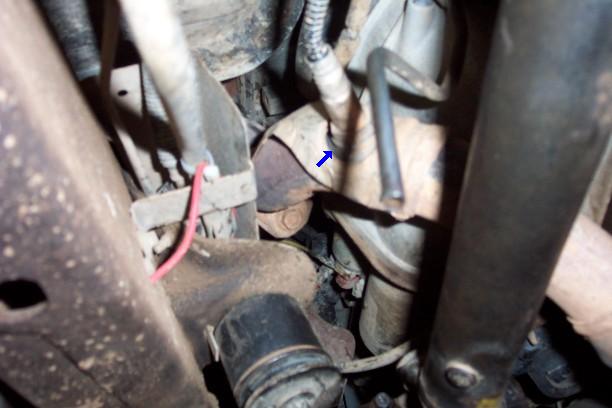

Not sure if we're looking at the same thing but I'm pretty sure the oxygen sensor is under the car next to the tranny. I was underneath yesterday and the drivers side (my passenger side) is definately easier to get to.
