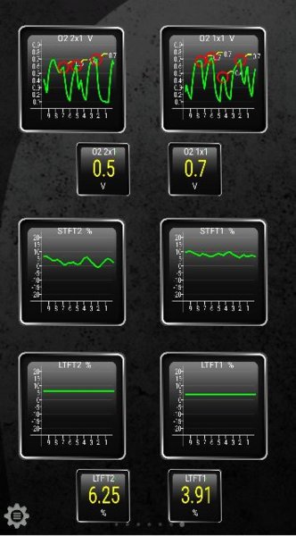

On a really hot day (over 40C) truck goes into Limp Home Mode (LHM) and will not drive faster than 15Kph. It is OK on other days! When it is running normally it drives and sounds fantastic having installed new timing chains, guides, valves etc. a year ago.
There are no fault codes showing with my OBDII scanner and the fuel trim values look reasonable both when it is running normally and when in LHM. The fuel pressure seems OK.

Fuel trims are a little high. I'm not aware of any limp mode in the 2000 explorer software in the US. What is your fuel pressure while running and hitting the gas? My other idea would be mass air flow issue.
Thanks for the suggestions which are very interesting especially the comment re no Limp Home Mode. I had assumed the computer was getting upset over something and limiting the speed to 15K per hour, even though there are no fault codes showing. The issue has to be either fuel or spark. When it is misbehaving it will just not drive at more than 15 K per hour. In neutral, the engine will rev to about 2,000 RPM and then misses and coughs and splutters.
