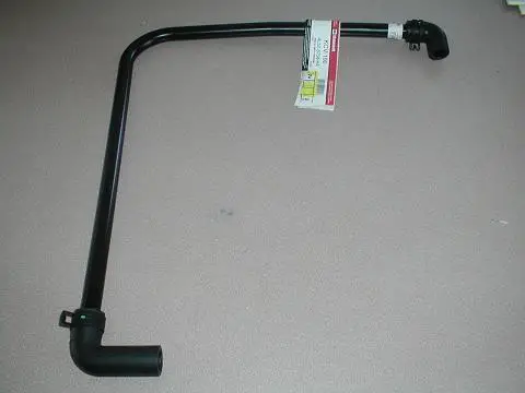

The elbow you changed it the front elbow, and the most common to fail. that tube runs around the back of the engine to the PCV valve, which you need to make sure is clean and not stuck open. There is another elbow on the back side of that tube but I have never heard of it failing .......... yet.
This is the one you changed, right?

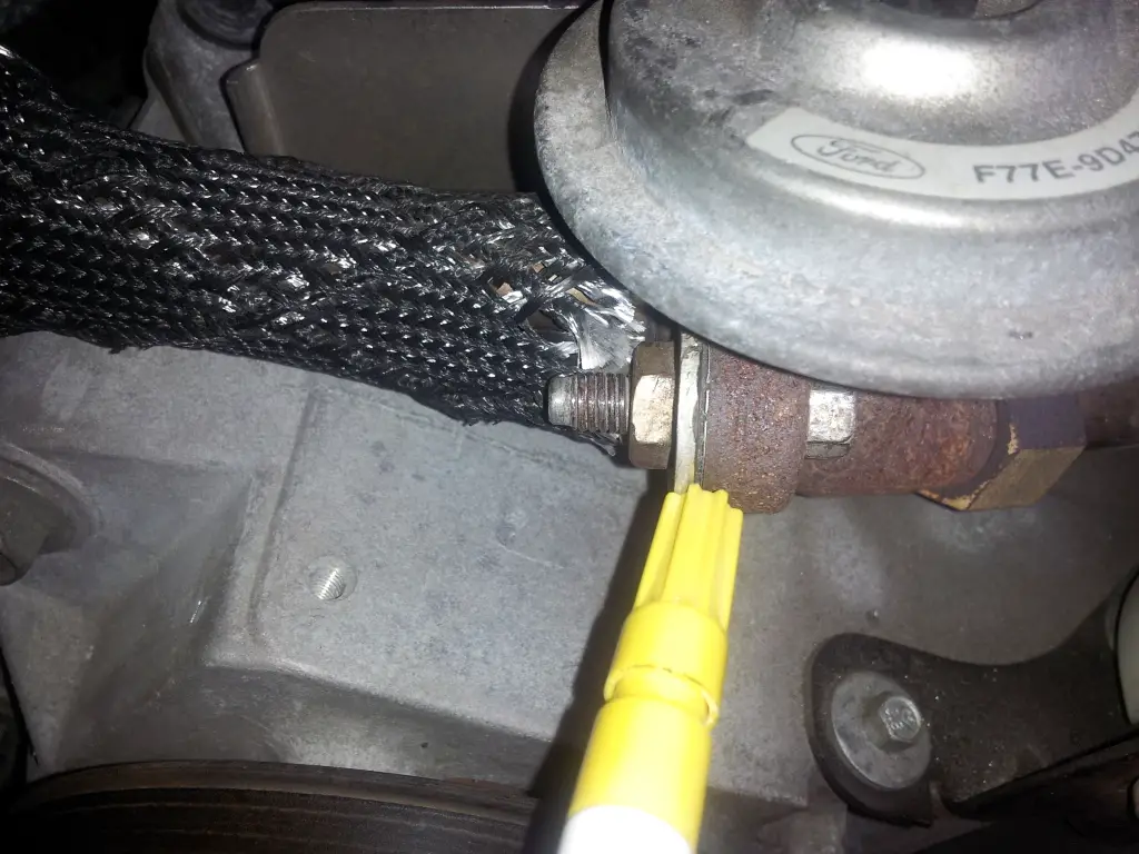

I just wanted to add...Also check the EGR valve, that was my problem at least. The little paper gaskets and such break down and ends up not sealing it right. Sometimes carbon gets caught up in there too and causes problems. I have found that carb cleaner is your best friend when looking for vacuum leaks! Just my 2 cents.

SO! When I sprayed carb cleaner around this area there was alot of reving (which means there is a leak) and so we took the thing apart! Come to find out the nuts were like tightened by fingers not a wrench!! Then we also found that the fabric like gasket had eroded away to nothing! So went to the autozone and bought a $2.60 gasket Put it on. THEN I put carb cleaner in the pod looking thing. THEN I turned the car on (Have someone with you) Rev the engine till its really screamin, and have your friend take the butt of a screwdriver and rap on that pod thing so that any carbon that built up in there would be released. Turn it off. Make sure all the connections are good and tight. Drive around for a little while and you should be good. :D :bounce:

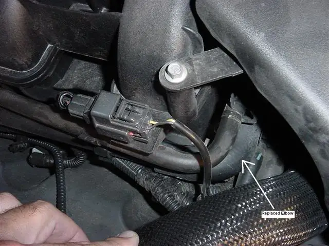

I replaced the PCV hose elbow at the front of the engine with this part.
Napa heater hose elbow #7296 Under $7, plus two 1-/8 hose clamps at Napa.
I will replace it with the Ford OEM part after reading this other post.
