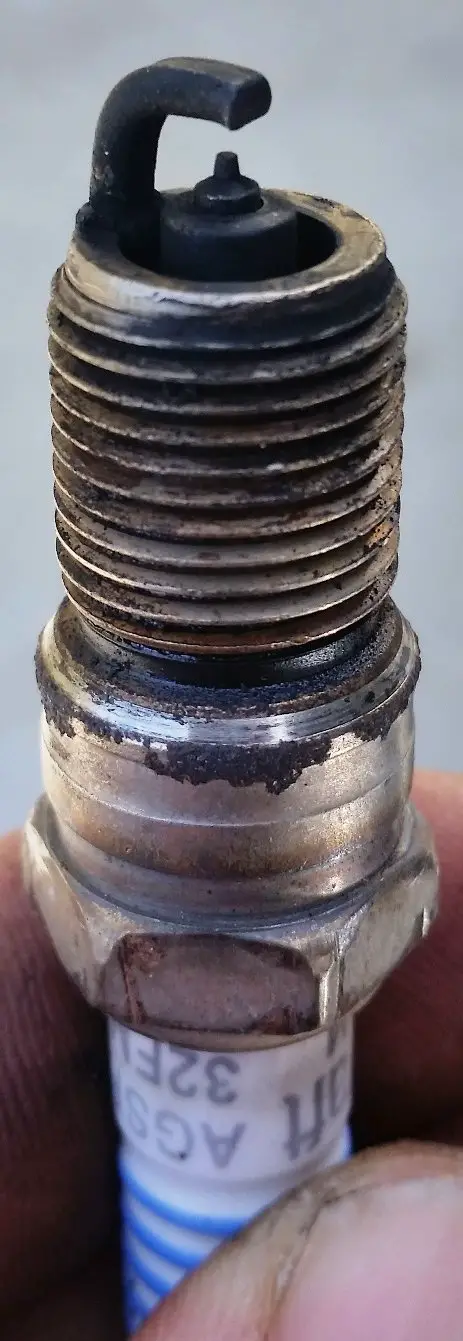

Compression test is good. 160 psi. Wiring / firing order is correct. Fuel presser tester has bad o ring, just spits fuel out of the shradder valve. The plug is fouled. black and oily. Going to swap wires and move on.

Cleaned the plug & reinstalled, swapped 1 & 2 wires, cleared the code. At first idling it seemed ok. put it in gear and rough as ---. It is back firing and once she was warm the exhaust has some white smoke to it. I now have 2 codes pending. P0301 & P0302. Cylinders 1 & 2 misfire. Using the stethoscope I can hear the injector clicking, it sounds just like #5. So I'm not sure where I'm at now. guidance????

Fixed.... For now. I had a junk plug laying around, well a new but cheap. I replaced the #1 plug and she's running great now. Do you all think the plug was bad or something odd caused it to go bad that I need to find?
Whoever put the plugs in probably dropped that one, new plugs generally are good unless you drop them.
That sooty plug may be the result of weak spark, caused by a bad wire. Your correct resistance measurement does not mean that the wire is good - their most common failure is not conductor breakage, but defects in the insulation - due to overheating, drying up, etc. Spraying water may or may not detect this. And no, a wire that failed that way won't cause the other plug connected to the opposite end of the same coil to misfire. Unless you know that the wires were replaced within the last couple years, I would just go ahead and replace them. Spend a few more $ and buy the ones with silicone insulation.

Plugs can be damaged during installation. All it takes is a bit of extra angle on the socket, you can deform the plug or crack the porcelain. I had a tiny crack in a plug that was barely visible causing all kinds of misfires.
