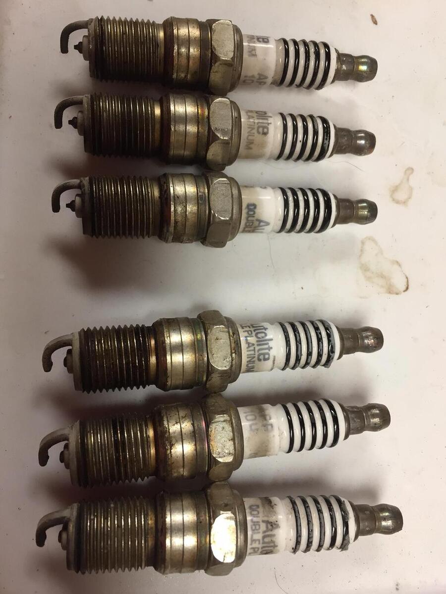

My bank 2 plugs would never have made 100K. They were Autolite double platinum's. Maybe the previous owner gaped them in such a way as to scrape the platinum coating off... ? IDK.
Here's an example (from a 6 cyl) of how my plugs looked (bank 1 on top, bank 2 on bottom):
Wow, toasted those left three were. I've seen some almost that bad, but it was my Mercury in 2004, with 98k on it, original plugs most likely. I wish the old fancy plugs that were in J.C. Whitney had been accepted. Those cost too much in the 1980 range, about $6-8 each then. But they had the four side electrodes with the tall center post. I think they just didn't sell, and the gap was not really adjustable. That was a great idea, but never caught on, until the Split-Fire contraptions come out. You can't find those now.
