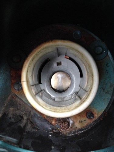

I finally got to take a closer look at the cap and filler neck situation:
As you can see there is a slight crack on the left side. Is it possible that something that small could throw the code?
there are 2 hose clamps down near the tank and 3 screws up where the cap is. the clamps may be rusty. if necessary cut them off. a crack that small could set the CEL if air can leak in. once fixed the CEL should turn itself off eventually, or you can try disconnecting the battery for 15 mins.
