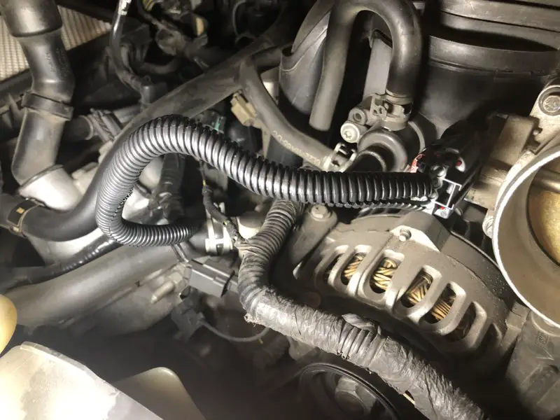

Been some time and wanted to post some of my discoveries which maybe help others.
The water leaking, the source was actually the windshield washer sprayers. Yes then ones on the hood that are perfectly over your rear 2 cylinders, my mechanic doused the rig with a water hose and still couldn’t reproduce. Every time it rained my cylinders filled up, yes i tried replacing them. I used oem ordered straight from the nearest Ford dealer and they still leaked. Ended up using a clear RTV on it.
Now onto the P2135 code, that seemed to get the P2104 and P2111 codes to accompany it. I have replaced the following:
TPS sensor : 3 times
Gas pedal sensor: once
Throttle body: twice.
Cut back the wiring harness a good 1-2foot back and no frayed or damaged wires grounding or shorting out.
New plugs (motorcraft)
Tried accel coils, brought the codes one quicker just replaced all with motorcraft and still codes.
I was down to complete wire harness and or computer which was left. Tried to see if any pig tails existed, there is the TPS plug only. I cut and soldered on a new motorcraft pigtail. Bingo no more P2135, I danced for joy.
3 days later P420 catalyst, but I wanted to note all the stuff I tried to maybe save some time and money for another. The tps pig tail was about $30-35 on amazon :
  • Motorcraft WPT1293 WIRE ASY
Thanks
Nick

@ng07exglenn Nice splice job! Good soldering, good shrink tubing. I detailed just how the gas pedal/TPS combination was designed to work in Post #13, here:
Inexpensive Adjustable IAC
if you care to look. The more we can figure out about this stuff, the less likely we wind up needing a Dealer! imp
