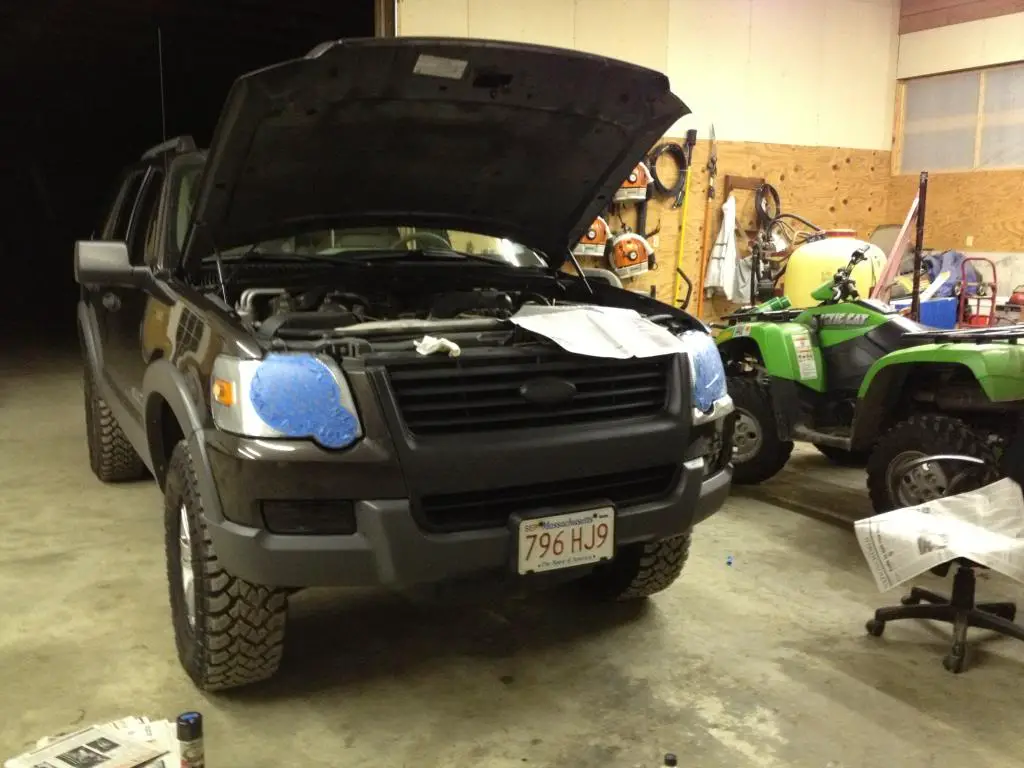

you then wanna take off the lens where the light would shine though, after you take that off take a wet towel or rag to white the other part of the lens to make sure its clean, you could do this step before taping the lens if you wanted to. also in this picture you can see how i painted my fog lights i love the look of the lights now with them tinted

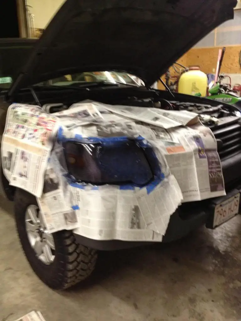

next step you want to use news papers to cover any of the body of the car
now its time to paint this was coat number 1 out of 2 and half coats. i say 2 and half because you do 2 full coats then the half is just a quick spray to give it a final little touch to it. i took a little piece of card board and put it over the reflector so the light does shine through a little bit

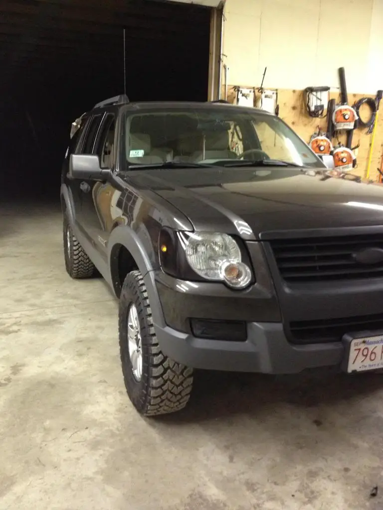

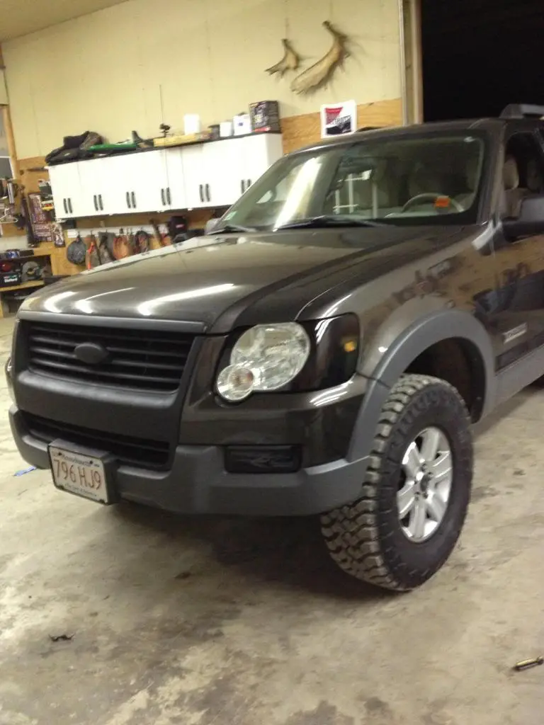

this is the final product as you can see here you can still see a small small portion of the reflector so the light does still show through perfect instead of it being completely black
this is the passenger headlamp as you can also see the reflect is visible in a small portion on the light

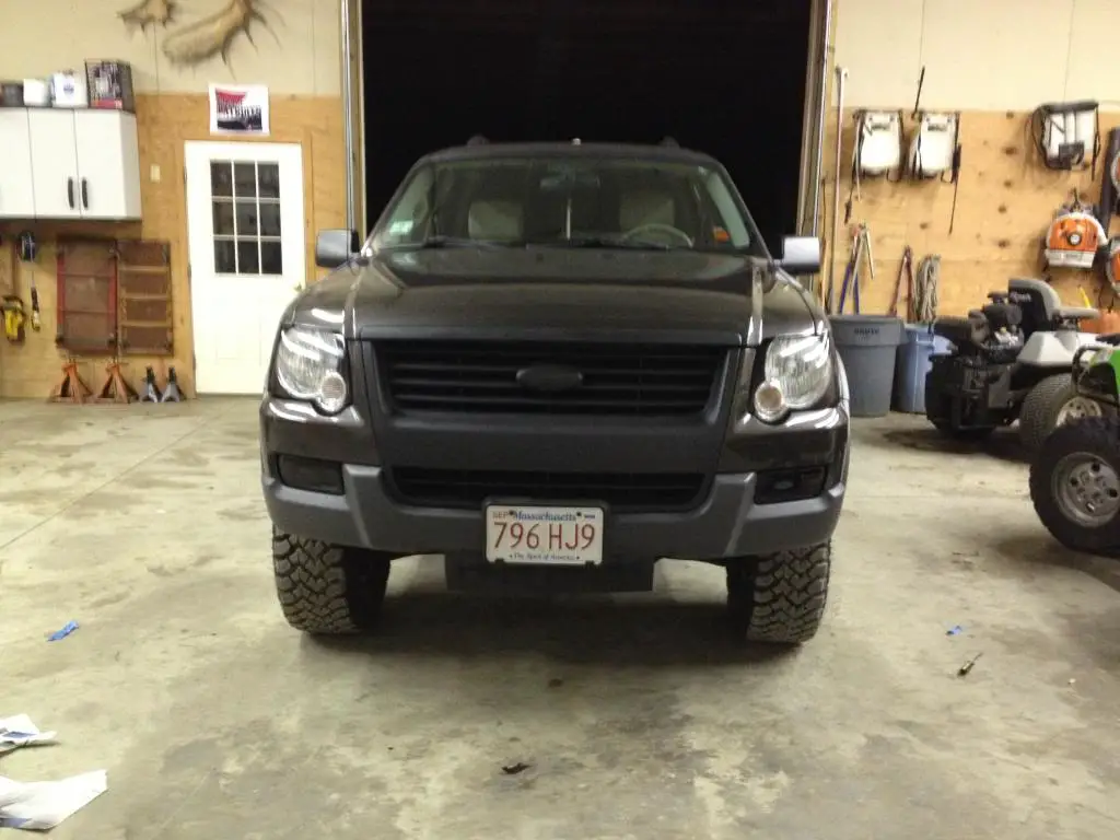

Front View also showing the painted fog lights
