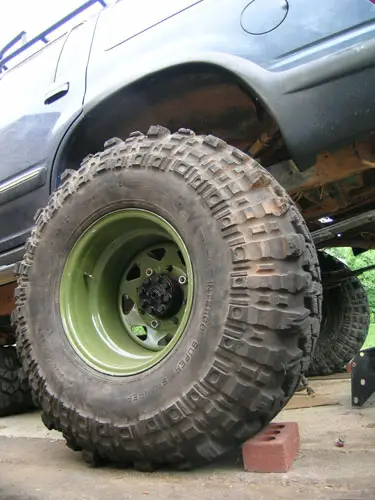

As you may remember, my wheels came bare metal (still had cutting oil from drilling the lug holes) so I had to paint mine. I used an epoxy for the base (white) and then smashed it with a green enamel. So far they've held up fine but it took a few days for the paint combo to completely cure.
