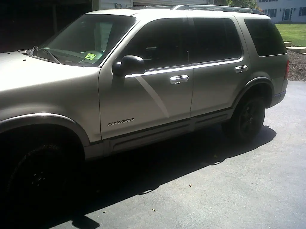

Hey guys, my trim was all scratched and faded so i decided to paint my bumpers and trim all with spray on black bed liner. It came out awesome it stands out and has a nice rugged look i was going for. If you have any questions ask. Also tell me what you think!

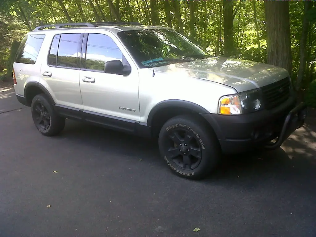

Here is the old and new together.....

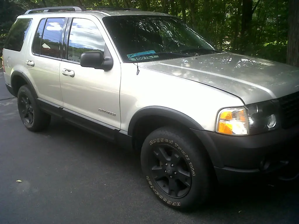

Here is the finished job.... plus the Pillars as well.
what kind of bed liner did you use, and did you take the trim off or just tape it?
I taped it off and it was pretty easy. I saw a post where a guy painted his rims using playing cards in between the rim and the tire so I used that method then taped it as well. Came out awesome. I used the rustoleum rattle can stuff and it is holding great. The only thing I can say is that if you have ever used any of the back to black or plastic rejuvenation stuff then make sure to wipe it down with acetone or lacquer thinner first or else the paint will scratch off easily.
