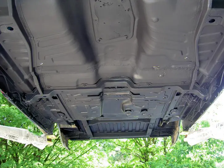

I recently used some por-15 to recoat my bumper and a few other places that needed some surface rust removed and was very pleased. It's very hard when it dries and it goes on fairly easily, and thick. I didn't spray it on since i was only doing smaller spots so I could finish up the Herc, but I plan on doing the underbody when it gets warm again.
Eastwood's Rust Encapsulator is the best mid coating, after rust killing, before topcoating. They have excellent rust killers also.
Topcoating is up to you from low cost paint cans, to engine paint(my choice), to undercoating. Regards,

so how hard was it taking the body off the frame? looks like haveing a few lifts make it possible.
I bought the lift as part of my body work budget.
