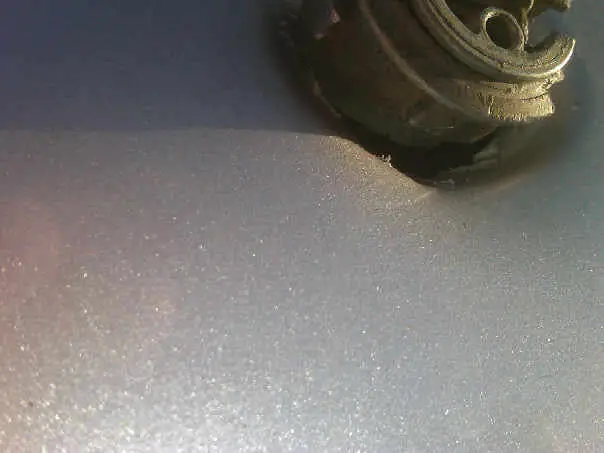

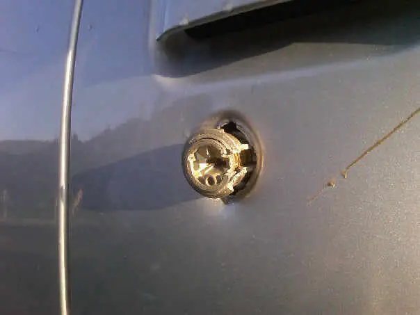

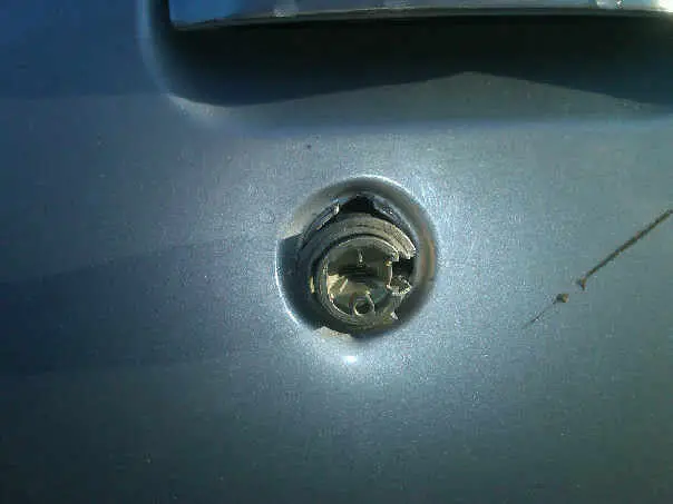

After further investigation the hole seems pretty out of whack. Not sure though so here are a few pictures. Any idea if I can still use it?
it was tough to get a decent picture so hopefully this is good enough. Thanks.
sorry but to the top. Need to get this fixed ASAP
That looks fixable, the door is the big issue there. You need to get that metal straightened out and be sure it's going to be strong enough. If it's not too torn as the bottom looks, you may be okay to just bend it back in shape. I'd tape off the area before you work on it, and use touch up paint where the paint is missing.
Find a new key cylinder and have it fixed to work with your other keys. Check the small arm on the back of the cylinder that connects to the rod. That is possibly broken also, so be sure that the cylinder is all that you need to buy.
If the bottom is shot and I can't get it to hold then what is my other option? Would I have to replace the whole door?
Well it will bend back to shape, but be gentle doing it. You want to keep the body straight around the hole, to avoid a trip to the body shop.
If it was very weak from the damage, the wost case would be to have a little welding done there to strengthen the area. That would hurt the paint too, so hopefully you can straighten out the hole without hurting it more. I looked and don't have a picture of my cylinder holes, I had to make mine larger(93 doors) to fit my 99 cylinders. Go slow with it.
Ill go slow bending it back and hopefully itll hold. Should the hole be perfectly round or should there be a notch at the top?
You will see it clearly when you take the cylinder out. The hole is not round, there are four squared cuts in it, top/bottom/left/right. The surface should be flat at the edges where the cylinder sets there.
