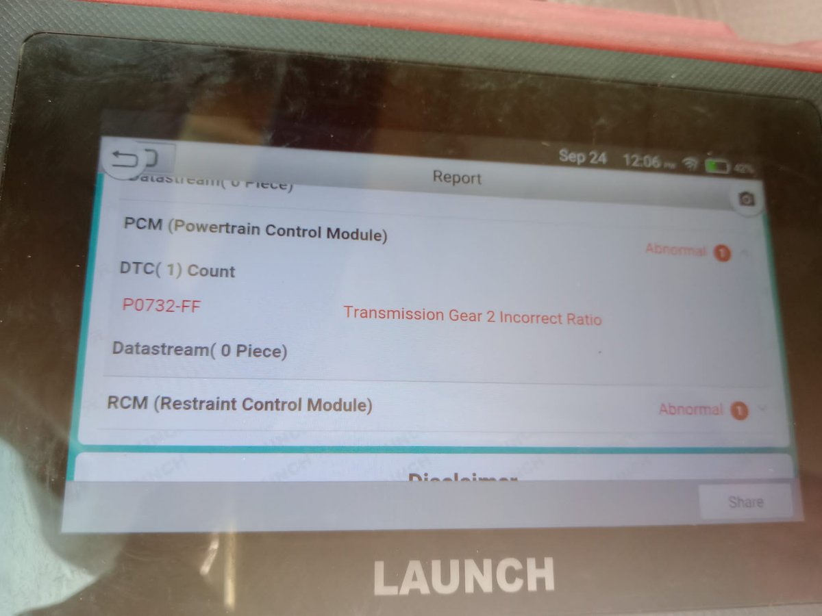

So it looks like you have a trans issue, incorrect gear ratio code p0732

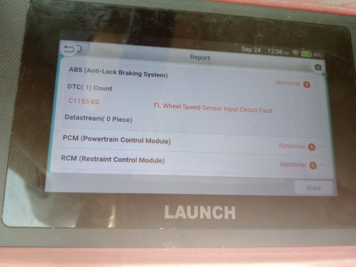

And an abs code for front wheel speed sensor

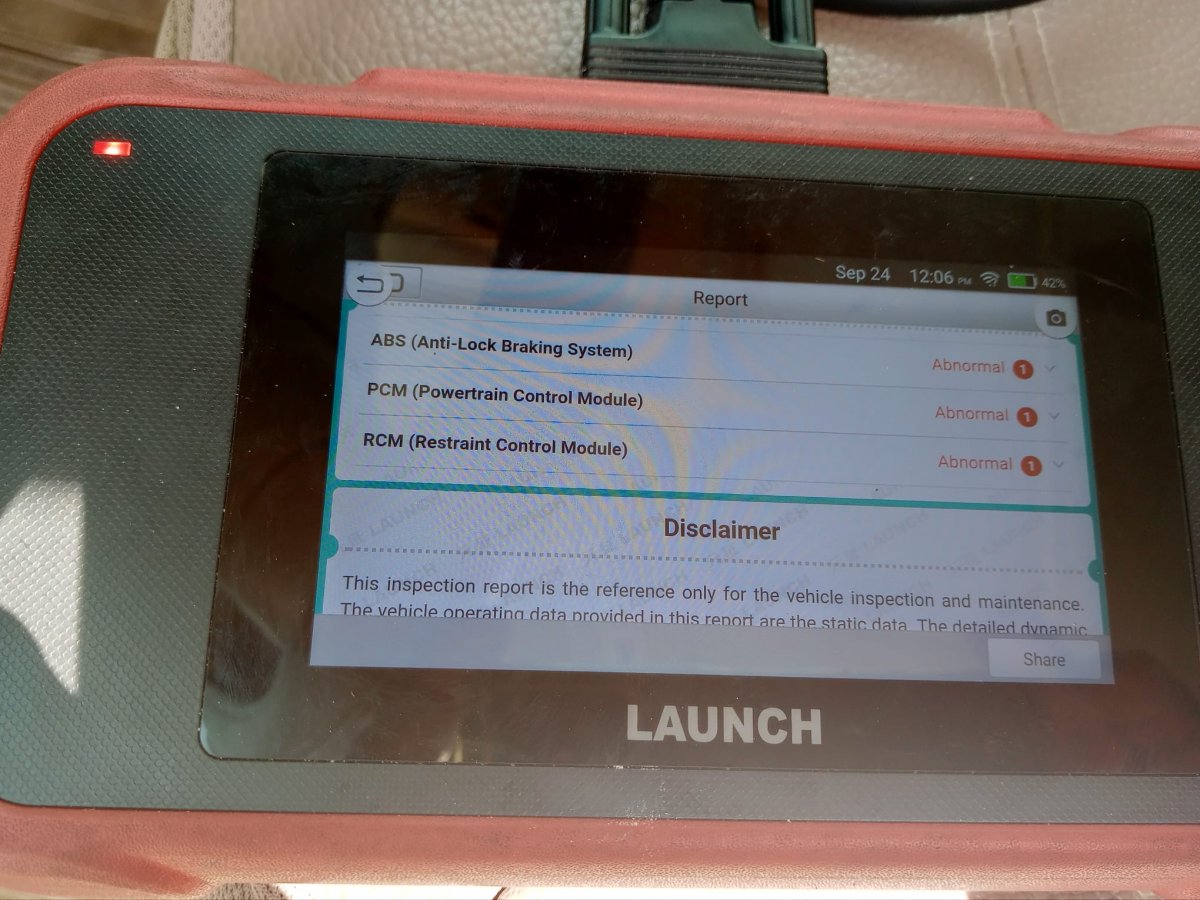

I’m not sure what the screen is with the “abnormal” messages
You are able to retrieve a trans code which means the pcm is talking to the scanner
Same with abs code, the scanner is able to talk to the abs controller
So to fix the Trans issues what needs to be done?
First thing to do is clear the code and see how long before it comes back
Are you experiencing issues/slipping with the trans? In second gear?
