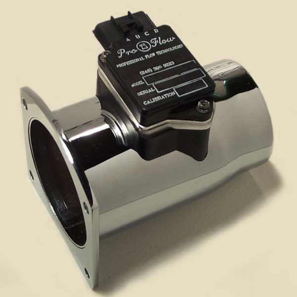

I agree with these guys, you need an exhaust system! That thing is corked up. A nice cat-back with really wake it up. We have the 3" cat-back system from Mac Products for $271.95. This has a chamber style muffler like a Flowmaster and has a nice tone. We also have the Pro-M 75mm Mass Air Sensor. It is available in chrome or black $244.95. It would go great with the K & N and the high performance exhaust system. THere is no throttle body upgrade that is a direct bolt on. You can make intended for a 5.0 Mustang work if you fabricate the linkage. If you want to go to the next level of performance we always have the X-Charger. This is an Eaton based supercharger that is good for 85 HP at the rear wheels. It works great on a stock engine and offers awsome lowend boost. We are about to launch a special on the V8 supercharger kit........$2999. While supplies last.

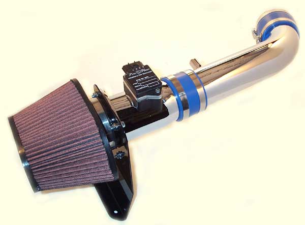

Here is the Pro-M shown with the Mac Intake.

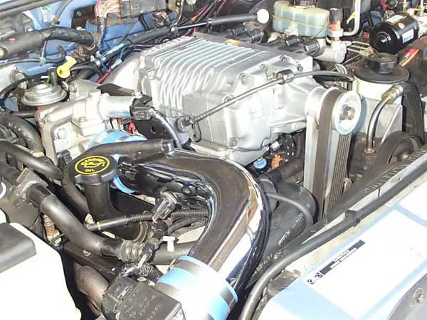

Here is the Mac Intake shown with the X-Charger!

i would not use a intake pipe that small nore would i use that small of a mass air. i would go with a 80mm pro-m no smaller.

We also have 80mm Pro-M Mass Air Sensors Available. The 75mm is very efffective when used with average mods (intake, exhaust, Apten Chip). You really need a larger throttle body to take advantage of a large MAF. There is currently none available made to directly fit a 5.0 Explorer. You can use an upgrade from a 5.0 Mustang but you would have to custom fabricate the linkage. Larger injector size and a supercharger would also work well with a 80mm or larger mass air sensor!
