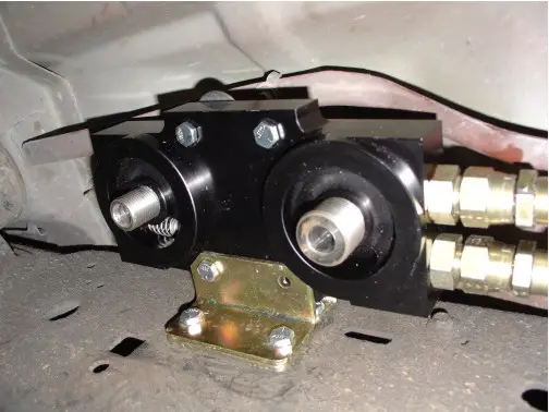

I wanted to know it I could use the amsoil full flow and Bypass filter with my perma cool dual remote? and will it be as effective. I can by the filter threads from Amsoil and use with my perma cool. I noticed that the Amsoil has some spring loaded restrictor for the bypass filter. The perma cool does not have this. Will this cause the Bypass filter to not get any flow? I don't the budget to just go buy the Amsoil kit plus filters. Any information would be greatly appreciated. :us:
If this is not feasable I will buy a donaldson spin on filter and one regular. I think they go down to 5 microns. I will have to research it again.

I am afraid that your idea would not work as you hope. Bypass Filters operates by filtering oil on a partial-flow basis. It shunts about ten percent of the oil supply at any one time and particles as small as 1/10 of a micron. The Amsoil Bypass Oil Filters filter all the oil in a six-quart system in about five minutes at an average engine speed equivalent to 45 mph. Your idea will not shunt the oil to the bypass filter; you would need a filter mount such as the Amsoil unit ( see picture ).
Your best bet would be to save until you can get the correct components.

As for the amsoil dual mount, I think the only difference I was targeting from the perma cool is the nipple sizes and the spring loaded restrictor that helps create some back pressure so the bypass filter will flow correctly. The Amsoil is clearly well machined and I am sure worth its price, but I cant dish out $200 and then more for the filters.
I was just wondering if someone actually tried the perma cool with amsoil setup.
If I was able to get my hands on one of those amsoil dual mount I am sure i could figure out how to adapt it to the perma cool.

You can purchase the Amsoil dual mount separately.
