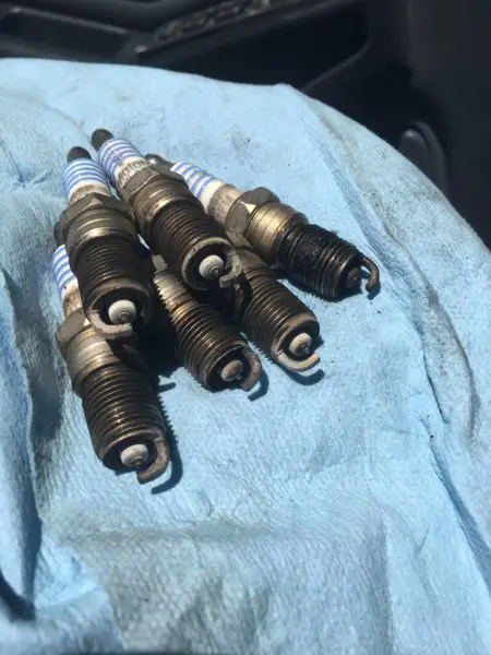

When I check the coolant every couple of months its maybe a quart low and here’s what the plugs look like the oddball is cylinder number 3, and I have yet to add oil before a compression test.

Cyl 3 spark plug is the dark one??
Cyl 4 had the low compression numbers??
