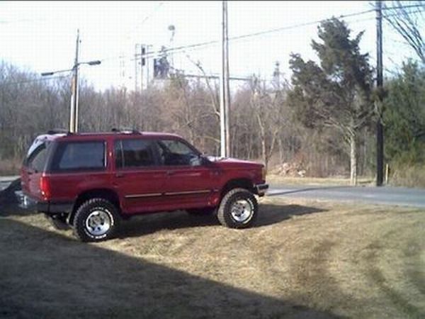

Heres a STUPID photoshop I did of my truck for a post a while back. Ignore the paint, but look at the "photoshop lift". I have 31's on that truck and that lift has GOT to be at least 3-4". It doesnt look too bad(well, short of the paint).
I think it will look good. Here, just minus 2"of lift and 2" of tire. LOL My point is it wont look stupid.

it wont' look stupid at all. When I had the 3" body lift, I couldn't fit 33's. They rubbed too much. 31's looked really good. Your wife should love it
