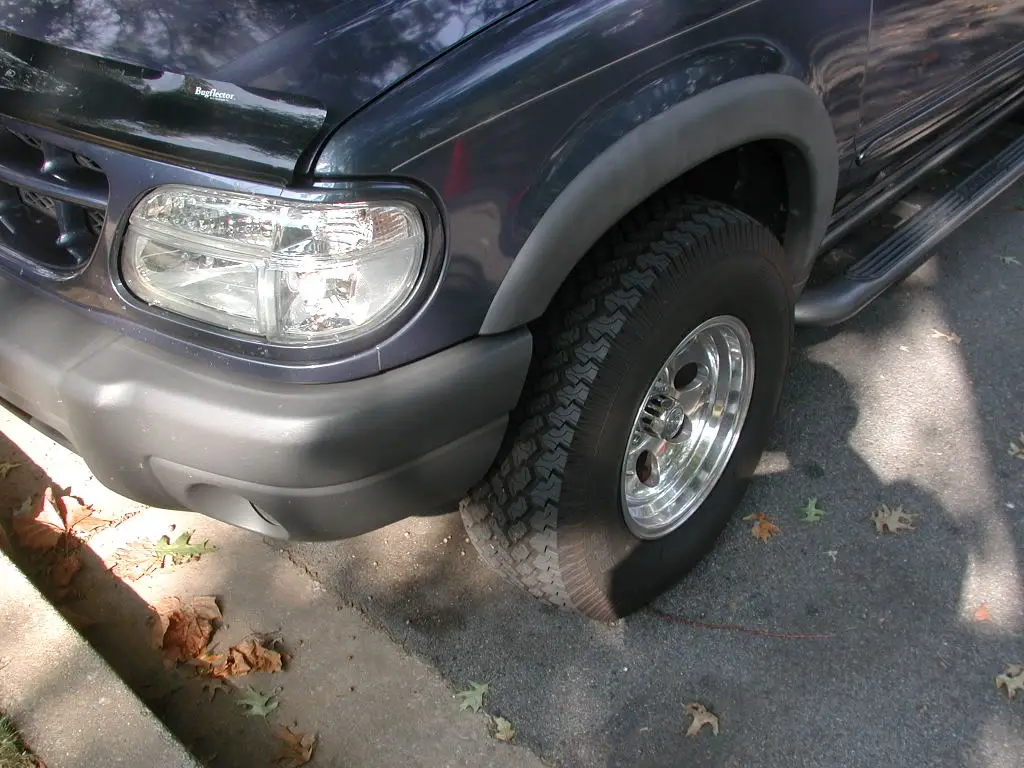

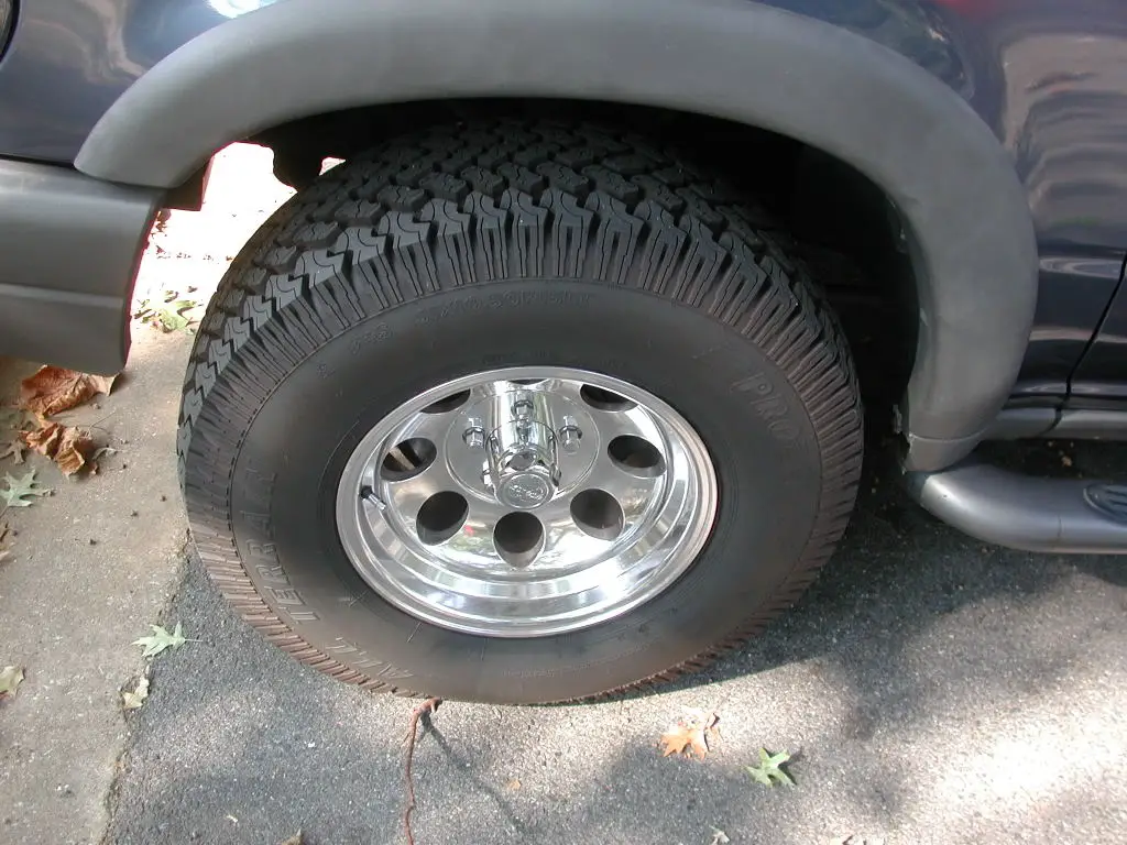

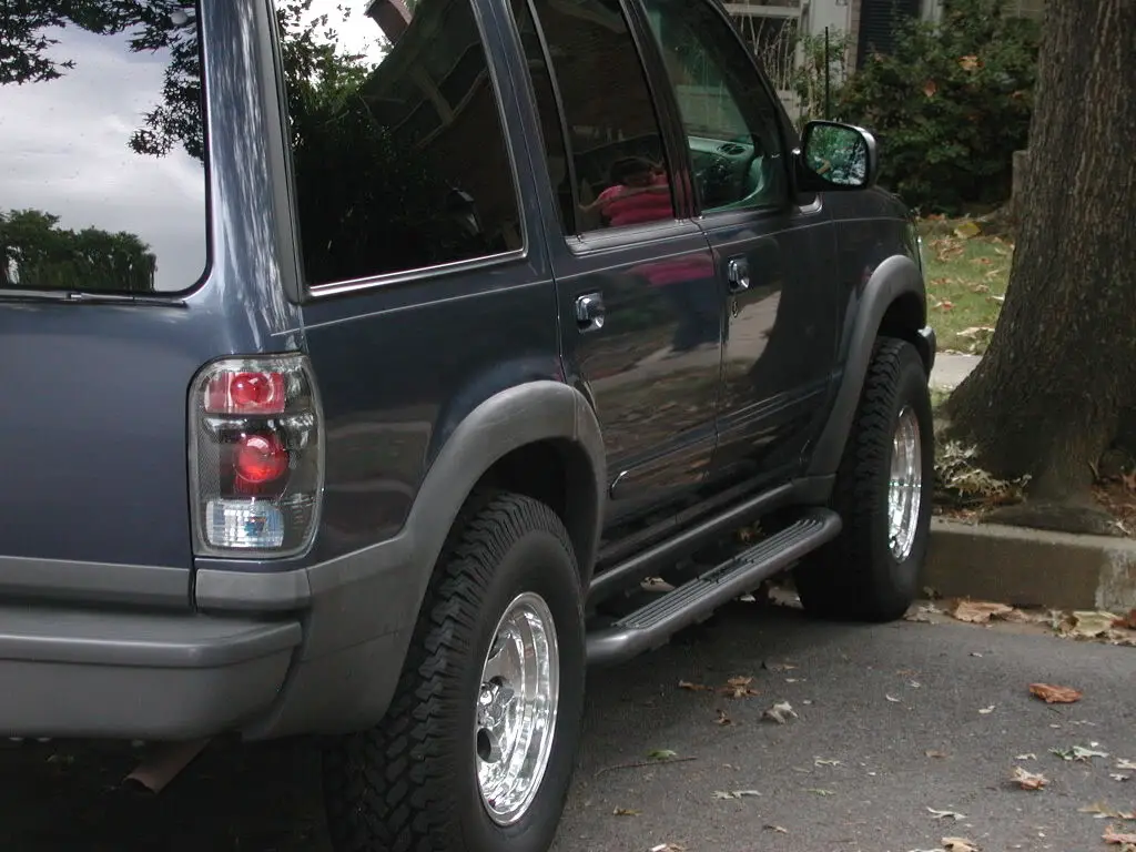

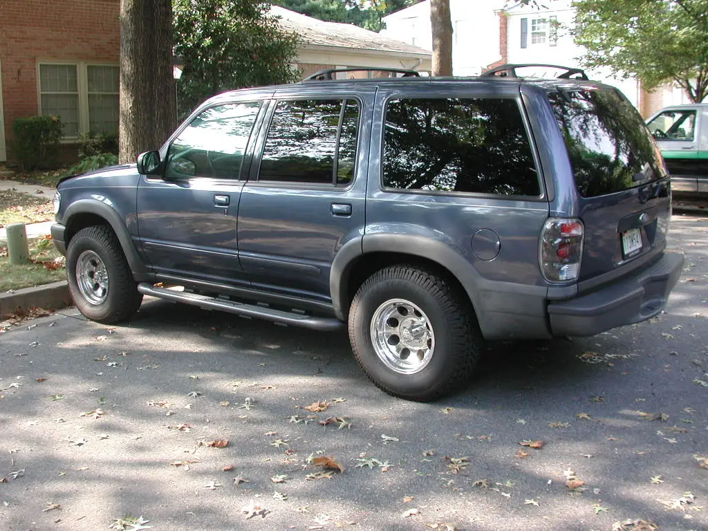

and here may be a few pics that are not in that thread. close as I have to straight on I guess.
Really those are too close for you to see how much they stick out.
but anyway,
I have 3.25 backspacing on 15X8 rim. if you can't tell from the pics, the tires stick out maybe an inch.

sorry bud, this is the best I got, you can kinda tell they stick out a little past my rubbermaid fenders, if your truck doesn't have these then it'll stick out more for you, so you have to take that into consideration.
You can see in the last pic where I had to trim a little so they don't rub.
Remember that these wheels have 3.25 BS.
