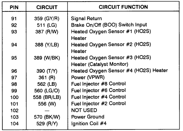

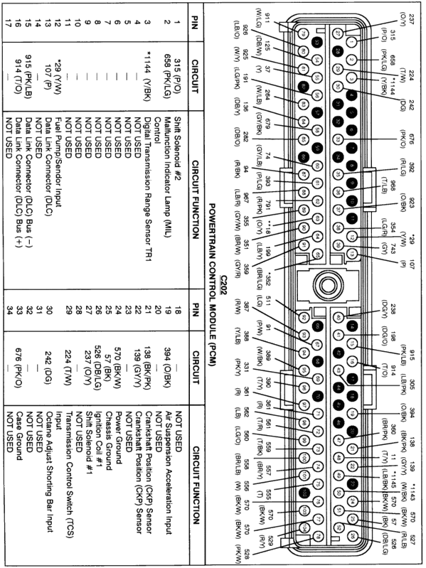

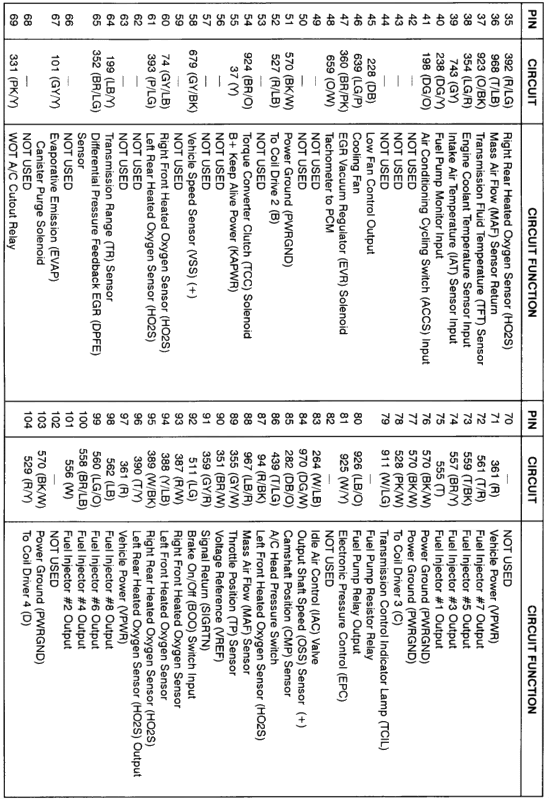

i've got an idea i'd like to try (swapping some ecu's around) and i would like to know if anyone has a pin diagram for the ecu.
on a side note, if someone has the pin out for a 97-98 mustang GT 5spd that would be cool as well.

the crank signals are the same and all the other pin locations that matter (injectors, crank sensor, etc..) are the same. a ground and speedometer single are then only different pin locations/circuit setups to the ECU.
i didn't pay enough attention to the transmission control circuits, they may work but that's some extra complexity that i removed lol
actually looks like i'll be trying a '98 calibration first, the fuel sender uses the same location. (once i find the files for the ecu calibrations lol)
