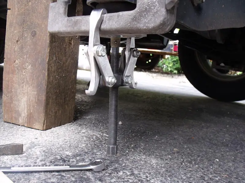

I use a 2 legged 6 inch gear puller.
Also used the gear puller after all other ideas failed

Ended up picking up the same exact gear puller scdix50 recommended and gonna give that a go tomorrow. Keep everyone posted!
