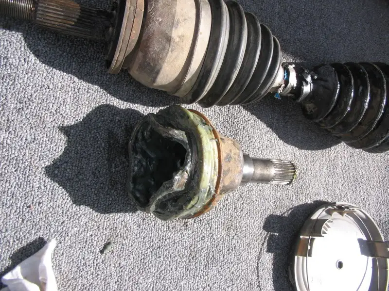

Most of the time when a C/V goes bad, you know it. The boot is torn up from the insides ripping it. They can and do, go bad slowly. The clicking noise IS the warning sign.
Blown C/V
