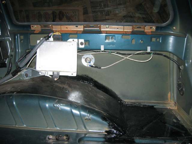

Sorry I can't be of more help.. but the stock AMP is located in the passenger side Trunk space as pictured below..
so its not really visible unless you remove the rear interior panel, is there anywhere to tell if you have one without all of that?
thats not really my concern, my concern is how i can wire my speaker leads up, even if it has an amp i'm willing to just run it thru the factory amp for now and do a bypass harness and all at a later time.... if possible, hopefully!
the gray wire i'm talking about does somewhat look like one of the gray wires going to the amp in that picture though... in thickness.

If you fold the Right rear seat forward you should be able to see the wire harness going to the factory amp (lift up the spring loaded cover plate). On the right (passenger) side of the vehicle this wire bundle is for the AMP, on the left (driver's) side these wire are for the 4x4 computer, washer rely, r def, r lock).
So if you have a wire bundle on the right you have a stock AMP.
