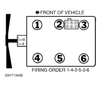

i have a 1996 explorer wires are crossed on drivers side coming out of the coil pack and the other side is not,, my guess this is wrong and they should go to the corresponding plug am i correct or do i need to go buy a manual??? please answers...bryan
They should be crossed...
If they were incorrect, I dont think it would run properly.
