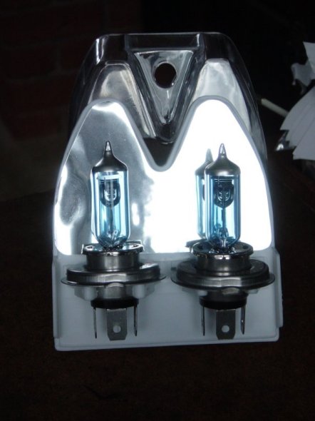

What you need are a set of better bulbs for your car. European X use Halogen H4 bulbs type P43T. They look like these.
These are waiting to go in my X - they are rated at 60 watt main beam and 55 watt dipped beam. These are the same power as the standard bulb in your car but give up to 30% more light than the standard. You can get bulbs that are rated much higher than this but they get much hotter and could damage your headlight. - Not good!
You should be able to get this type of bulb from a good motor accessory shop. They give a blue tinted light and are supposed to be good in adverse weather conditions.

H4 P43T
