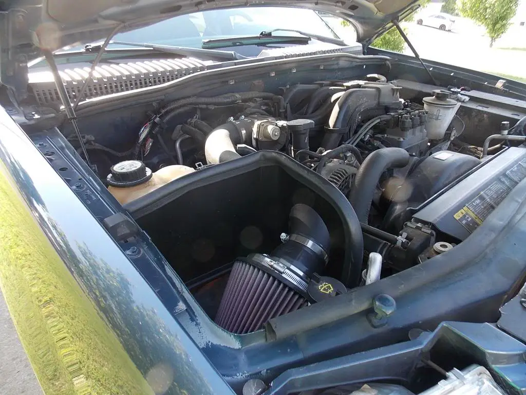

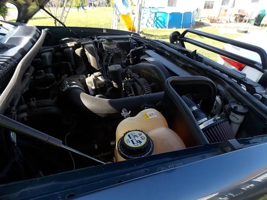

It will fit, here's some pic's of mine.
that looks simple enough, just removing the stock one. do you have the model number for the K&N you put on ? looks great.
Here you go. 2004 FORD EXPLORER K&N 57 Series FIPK Air Intakes 57-2564.
