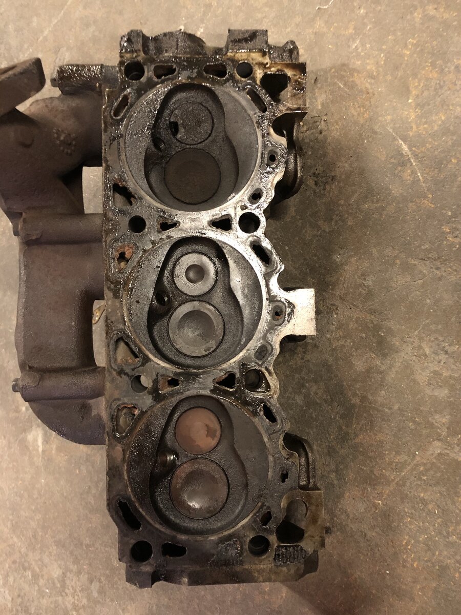

Got the heads pulled today - see if you can spot the cause of the compression loss!
fortunately the bores look great, so the chunk of valve must have just left through the exhaust.
off to be rebuilt!

That is a new one to me, I have never seen a valve missing a piece
Any cracks in the areas between the valves? (Hard to see on the cylinder at bottom)
Yes indeed, crack between the valves on the rearmost cylinder (top in the picture). Also had a head gasket failure between all three cylinders, which explains the compression leak.
The machine shop ordered a new casting, and it'll be all good by next tuesday!
