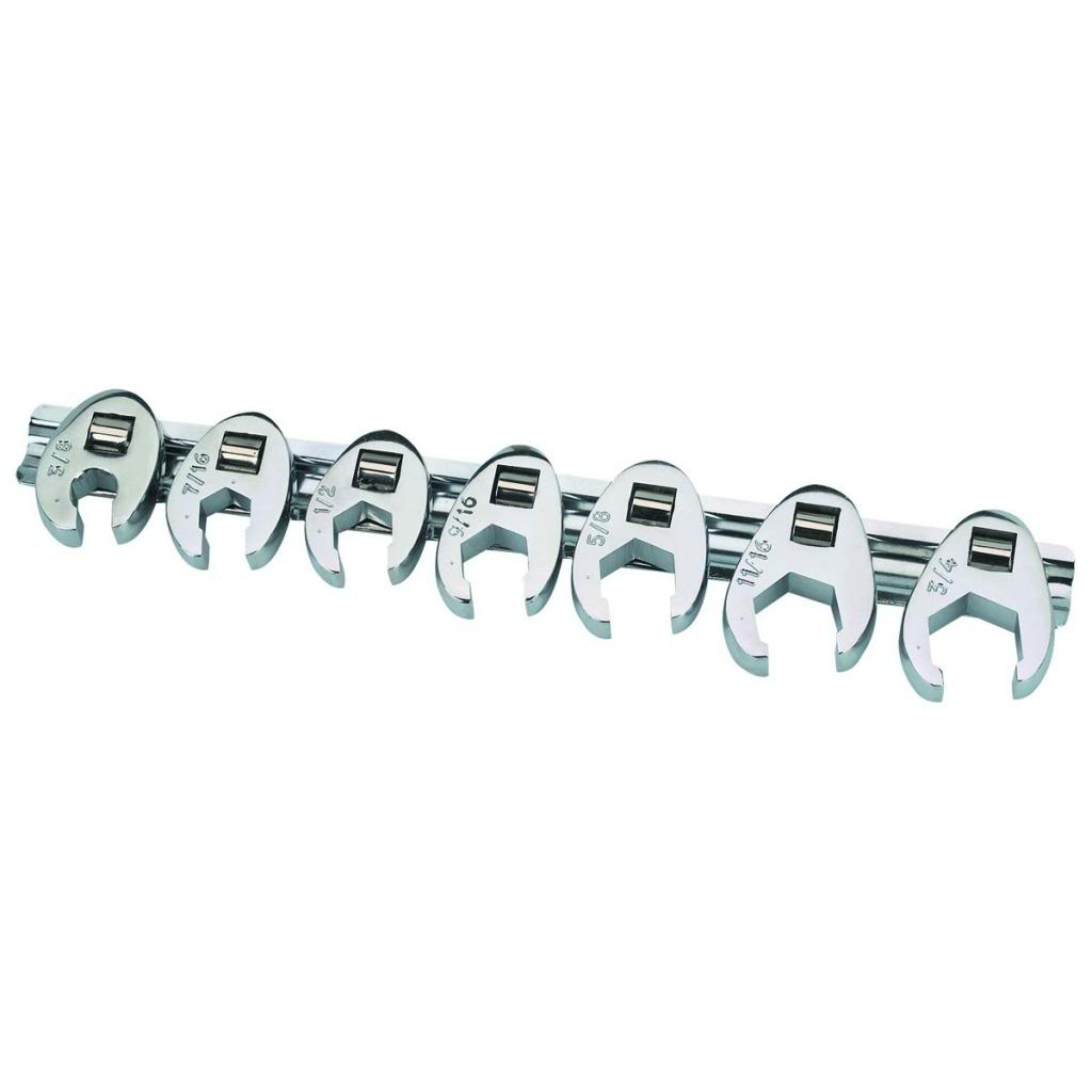

Recommend using a Crows foot line wrench. The material is soft and this will make getting the fittings off a snap: Metric set for these trucks
Right on, thank you. Was the part I listed correct? Is the pump side of the connection still good?
Yes, and yes. Both of the connections come with the hose, just unscrew and replace.
Advance has a 30 percent off coupon on line if you dig for it. Both lines and a gallon of PS fluid was 32 bucks. I did invest in a set of SAE crowsfoot that were helpful. I just did the return line that was leaking BAD. I didn't bleed it though the fluid looked like it was circulating. I don't want to get too crazy on the 4.0 while it lasts..
