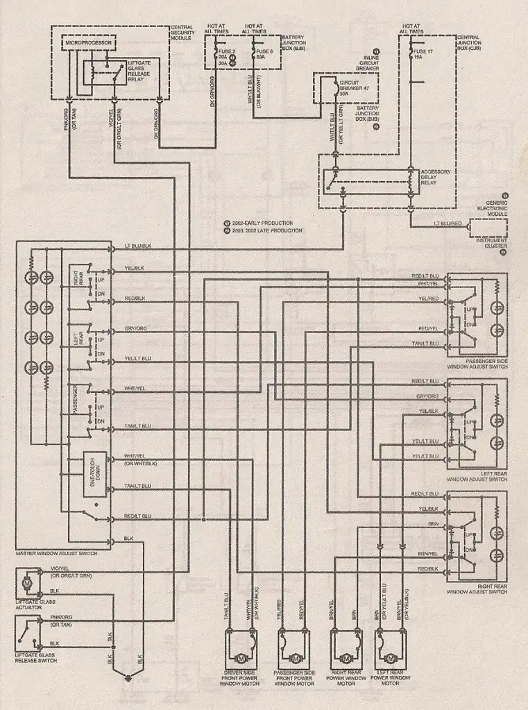

Hi, I'm having problems with my 2002 ford explorer. The drivers side main control will roll down the passenger side front, but will not roll it back up. The control at the front passenger door will not roll it down, but will roll it back up. I've been looking for a wiring diagram for the circuit, but not luck. I have searched this forum with no luck either. Any help on this would be greatly appreciated. Thanks.

Drivembig, A lot of electrical issues can be attributed to broken/damaged wire(s) in the boot between the driver's door and the body. This is common with our Ex's. As far as I know all the wiring for the windows go through the master switch in the driver's door. I would check for broken/damaged wire(s) first since this will be the least costly solution. If nothing is found in the boot or repaired wire(s) don't fix the problem, then the troubleshooting steps should help you pinpoint the issue.
Here is a great thread for removing the door panel, thanks to borland for the awesome write-up: http://www.explorerforum.com/forums/showthread.php?t=249253
Here is a great thread for checking for broken/damaged wires, thanks to synyster for this awesome write-up: http://www.explorerforum.com/forums//showthread.php?t=270081
Here is a great link for troubleshooting the power windows, I recommend downloading it so you have it for future reference. Thanks to theofam for this great link Dead Link Removed
Here is the wiring diagram from my Haynes Manual:
