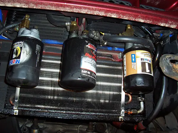

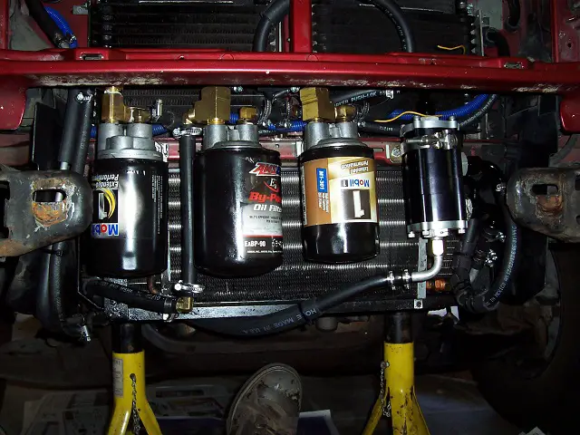

I like the 215 degree level for oil, so hopefully the 302 stock oil cooler will be plenty. Adding an Amsoil bypass filter and full flow filter should make capacity at least seven quarts, a good amount for severe duty, much better than five total.
Dale or others, I'd still love to hear good opinions about ATF temps. I do not like the concept of heating ATF with the radiator to 180* and using a small cooler in front. I'd prefer a thermostat controlled cooler system, and bring the temps down to a lower and narrower range. So what would the best ATF temps be, 100*, 120*, 140* or what? I tend to think 120 should be enough, but maybe 140 might be an ideal level.
For my mail truck I can justify adding the same Amsoil bypass filter and full flow filter for the transmission. I envision using the sandwich adapter with a thermostat in it to divert ATF to the front cooler. I have two Super Duty trans coolers that I got from eBay years ago. I'm wondering how much trouble it would be to modify the sandwich adapter thermostat to open sooner, at a temperature in the 130* range or so. That would stop a big cooler from slowing warm up time, and keep the ATF cooler. Skipping the radiator is my plan. I can see the capacity nearing 18 quarts that way, having a deep trans pan also. Stock is 12-13, the filters are a good 2-3, then the pan is two more.
Amsoil has free shipping now until tomorrow online, code is FREESHIPPING100.
I'll get on those projects once I get my 5R55E truck running again. I'll do the trans filters for my new 98 truck then, the engine bypass systems next. I wish the V6 had the oil filter in the front, but I'll place the lines as intended for the 302 swap later. I see two "Y" blocks in the system, run the oil filters in parallel back to a basic adapter. I like the spot next to the frame behind the front body mount the best, maybe longer filters will fit their also.
