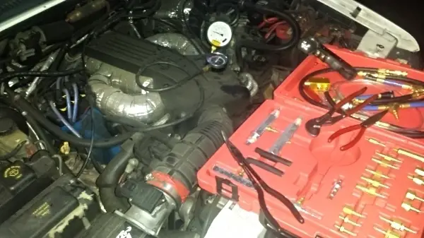

I finally got my Fuel pressure kit and did the procedures but yeah its showing very low pressure and yes maybe its time for me to change the fuel pump which Ive been planning for ages...
here's what it looks like on IDLE.... and even though I REV the engine to 3000rpm the needle did not move at all...
I noticed too soon I turned the ignition on it took time to get up the pressure....
may I ask what is (WOT)...?
Wide Open Throttle
I checked all the vacuums and I think its time for the pump and see how it goes...... :thumbsup::thumbsup::thumbsup:
